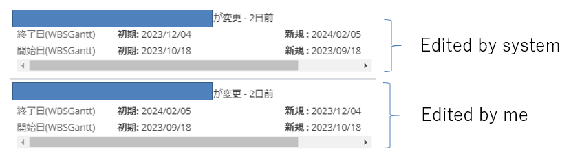

Specific Example:
Start Date: 2023/10/18
End Date: 2023/12/4
  * Automatically adjusted without any manual settings
Start Date: 2023/9/18
End Date: 2024/2/5

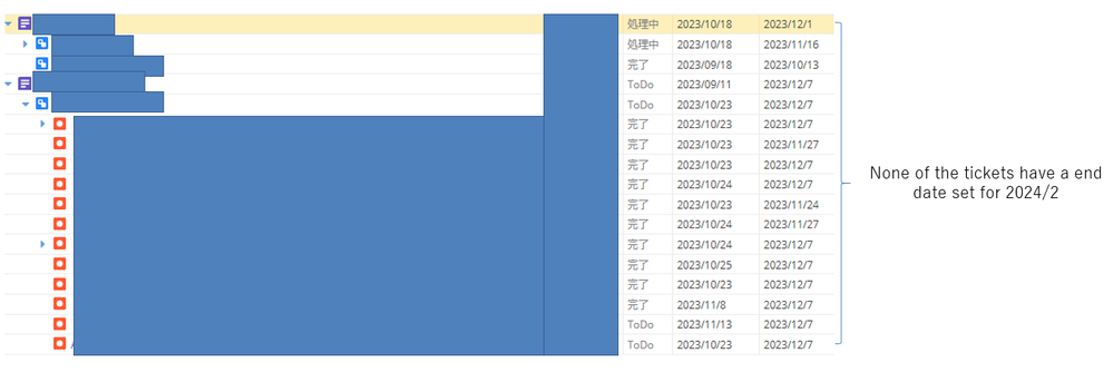

image.pngNo ticket has an end date set for 2024.

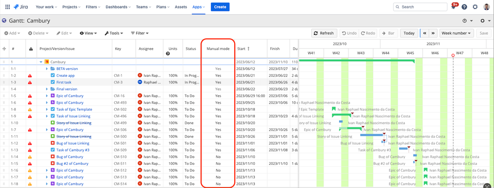

The workaround is to set the Manual Mode to Yes, this will prevent this phenomenon. You can refer to our documentation regarding this matter here. It’s the Manual Mode column on Gantt-Chart, as follows:

Yes, unfortunately, at the moment that's the only workaround we have. You need to manually set the Manual Mode to Yes to all the issues you need to in your Gantt.
