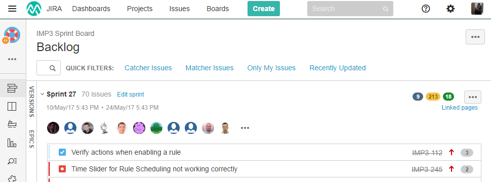

The number of done points at the top of the sprint board is incorrect. How do I get it to accept any of the resolutions (including the custom ones) as being done (it's the number in green at the top right of the pic)?

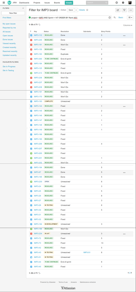

Thanks Nic. Here's the first page of issues:

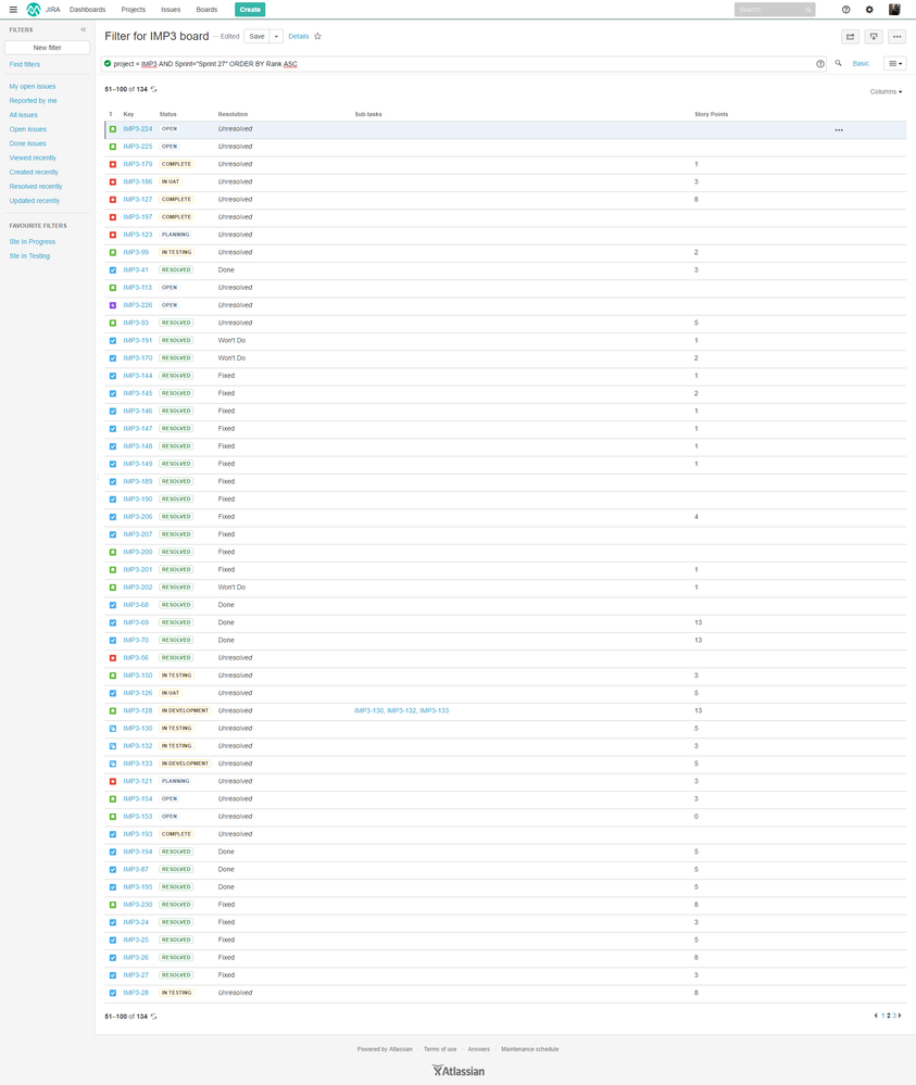

Here's the 2nd page Nic:

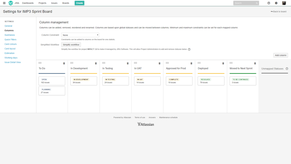

Go to board configuration and look at the column setting - each column should contain one or more status, we'd like to see which status are in the far-right column.
Steve Doggett
May 31, 2017
Is this what you mean?
Steve Doggett
June 1, 2017
We've worked it out... The ordering of the board columns makes a difference. Moving the `Deployed` column to the end fixed the problem. That was annoying and really not obvious...
