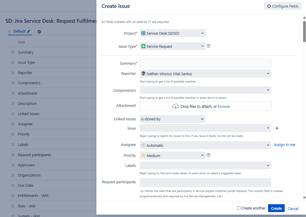

The field works while creating an issue and it appears on the ServiceDesk view inside the project.
It even have the edit button appearing, but once clicked it opens the Edit Issue screen where the field is missing.

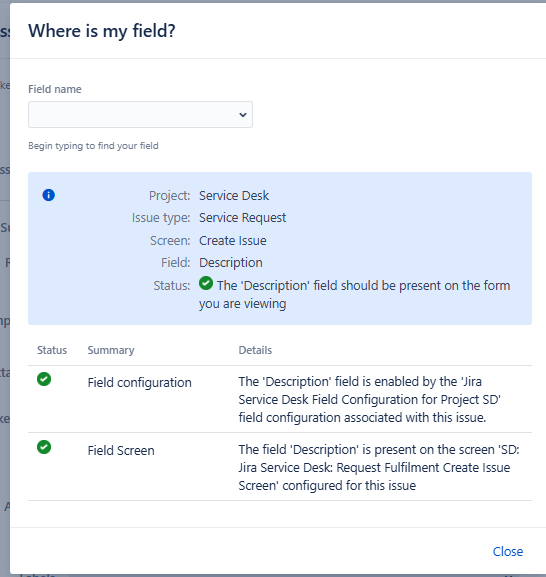

The "where is my field?" helper says that it should appear on the screen.

  • Did you use the where is my field option on an issue, what is the response?

    There are 3 screens: Create, View and Edit. The "Description" field is present in all of them. I've later noticed that the field also didn't appear on the "Create" Screen through JSM (not portal).
