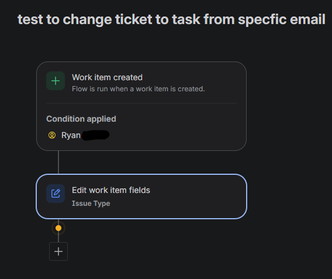

I am trying to setup a simple automation the converts a incoming email request from a specific email into a Task.
When i do some testing i get the error The issue type selected is invalid. (issuetype)). Below is a screen shot of the automation rule in me Dev project
It is a very simple rule, i know but just need a simple change to happen when a issue is raised via email.
Any help would be great.
Thanks

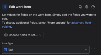

Can you share a screenshot of the details of how you are editing the Issue Type? Also for the work item created - does the issue type for it have the same workflow as the issue type you are trying to change it to? Or are they different?

Here is the screenshot of the Issue Type
Apologies but i am not 100% sure i understand the 2nd part of your question regarding workflow, i am still new it jira and learning the ins and outs of the back end of it.

Thanks for sharing the screenshots. Automation rules don't currently have the ability to do a Move function between Issue Types if the Issue Types are connected to different Workflows. If they use the same workflow then you can do a simple edit like you are doing. What is the work type/issue type of the issue that was created?
Then check the workflow scheme attached to the space/project and see if the different work types use different workflows.

When the request comes in it is a (system) Service request.
I have a suspicion the workflows will be different, looking the the workflow diagrams for Task and Service request they are two very different workflows. So i then assume what i want to do will not work?
Thanks
John Funk
May 15, 2026
That's correct. So, you should review both workflows to see if that are really that different - maybe you can use the same workflow for both. Then you could do it.
