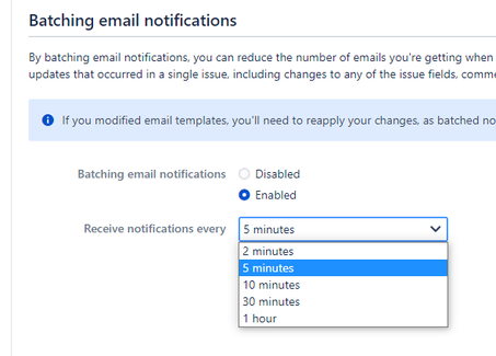

Usually email batching notification may take up to 1 hour but not 6 hours:

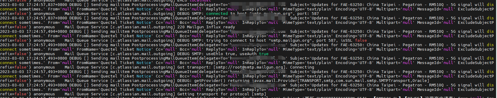

I would check your SMTP server as well as the jira logs and possibly the jira time.
I'm going to set this for every 10 minutes

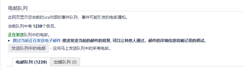

I find that there are a lot of email queues in my jira system. Will it affect the time of receiving emails? How can I solve this problem
@arno take a look at this KB https://confluence.atlassian.com/jirakb/troubleshoot-notifications-in-jira-203394737.html

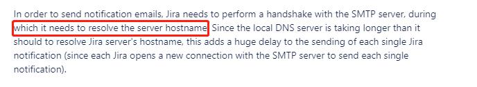

I don't quite understand the solution of this article(https://confluence.atlassian.com/jirakb/jira-notifications-piling-up-in-the-mail-queue-due-to-jira-server-hostname-dns-resolution-issue-1031835684.html). Could you tell me what I should do

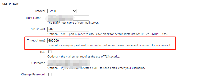

I have tested the SMTP server and port, and everything is normal. I adjusted Timeout (ms) to 60000 and set Schedule to the default value, but found that it could not fundamentally solve my problem
