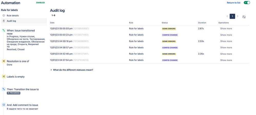

Ivan Andrieiev
January 12, 2023
@Ste Wright  I created a the Automation Rule. Bu it didn't back issue in other status. I suppose I did some wrong.
Text mistake:
Destination status could not be resolved. If using a smart-value ensure this resolves to a numeric status ID or untranslated name for issues (with current status):
TS-84 (Closed - 6)
Ste Wright
January 12, 2023
Hi @Ivan Andrieiev
Simple question first - on your Workflow, can you transition from "Closed" back to "In Progress" normally?
Ste
Ivan Andrieiev
January 12, 2023
yes you are right, it is really very simple question, thanks.
Like Ste Wright likes this
