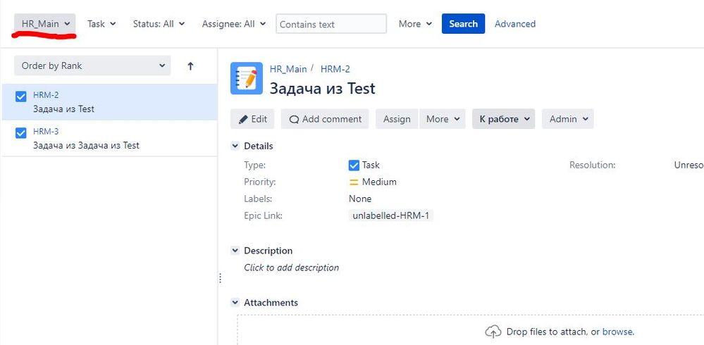

The board can be found in the all boards tab. And you can see that the filter has been applied
If you go to the settings again, the project name in the filter shows as numbers
Why can this happen and how can it be fixed?

All right, guys, I've solved the problem.
Here's for anyone else who's going to have the same problem.
I clicked on the Advanced button and the numbers instead of the project name were displayed.
1
I manually entered the project name and saved it.
Everything worked, the board did not disappear from the project (if do the same for a board that disappeared, it will be displayed in the project again.)

Try to click on the Edit Filter Query link. Then if it still has numbers for the project, change it back to HRM.
It's a kanban board.
If reopen the filters, the project is displayed correctly there.
But I understand that this is not the case. Any change in filters causes the board to disappear from the project.
