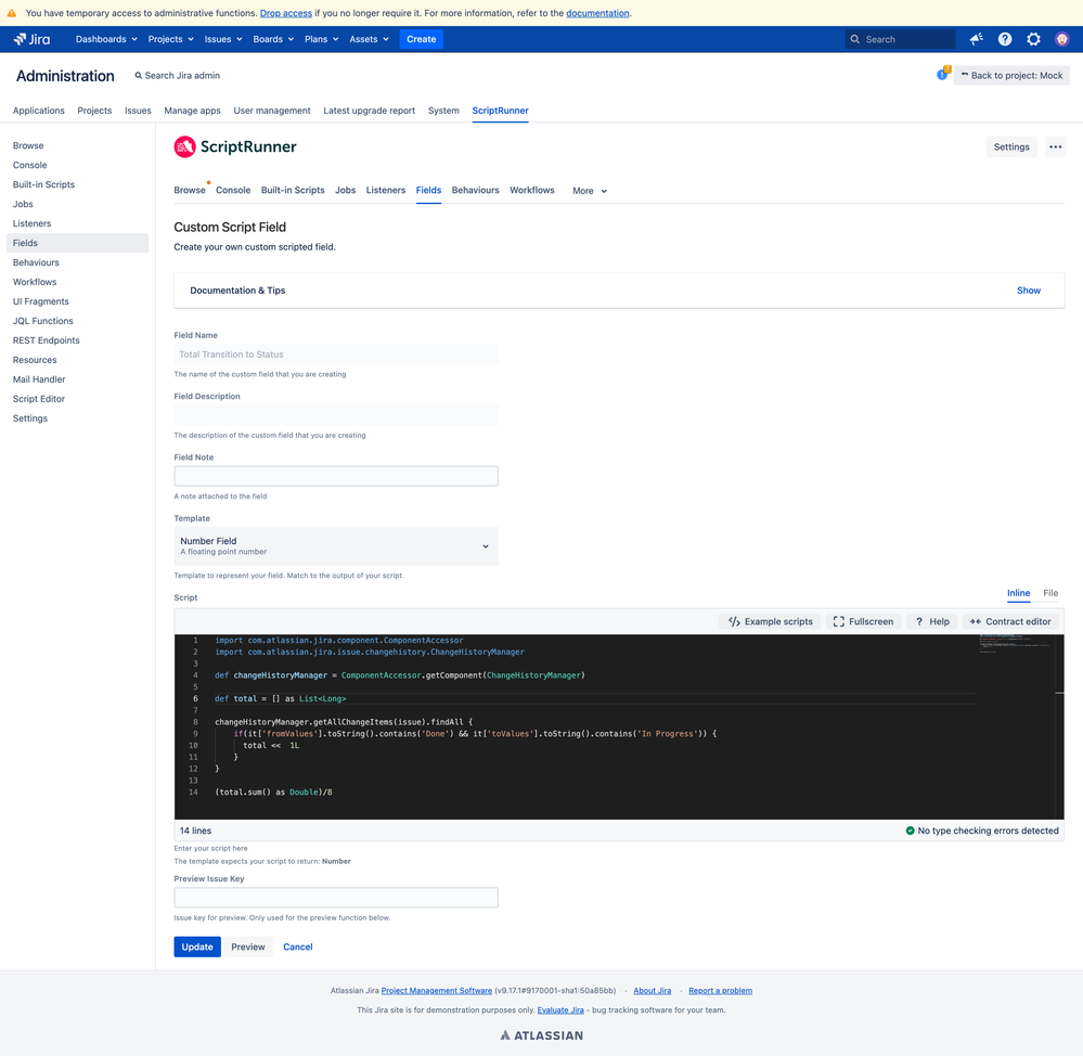

For your requirement, you could do this easily with a Custom Scripted Field of Number type and use a code like this:-
import com.atlassian.jira.component.ComponentAccessor
import com.atlassian.jira.issue.changehistory.ChangeHistoryManager
def changeHistoryManager = ComponentAccessor.getComponent(ChangeHistoryManager)
def total = [] as List<Long>
changeHistoryManager.getAllChangeItems(issue).findAll {
if(it['fromValues'].toString().contains('Done') && it['toValues'].toString().contains('In Progress')) {
total << 1L
(total.sum() as Double)/8
Please note that the sample code above is not 100% exact to your environment. Hence, you must make the required modifications.
This will calculate the average number of times an issue is transitioned from one status to another, on average, 8 hours per day.
Below is a screenshot of the Scripted Field configuration:-
I hope this helps to solve your question. :-)

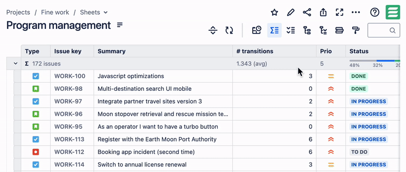

if you're open to solutions from the Atlassian Marketplace, I think you'd like the app that my team and I are working on, JXL for Jira.
JXL is a full-fledged spreadsheet/table view for your issues that allows viewing, inline-editing, sorting, and filtering by all your issue fields, much like you’d do in e.g. Excel or Google Sheets. It also comes with,
  • a range of advanced features, including support for (configurable) issue hierarchies, issue grouping by any issue field(s), sum-ups, or conditional formatting,
  • a long list of so-called history columns that aren’t natively available, including the number of status changes between [status] and [status], and many, many more.
With these, you can build a view like e.g. this in just a couple of clicks:
As you can see above, you can easily sort and filter by your history columns, and also use them across JXL's advanced features, such as support for (configurable) issue hierarchies, issue grouping by any issue field(s), sum-ups, or conditional formatting.

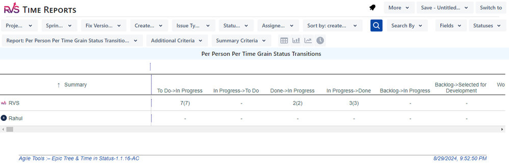

Hi @jira_admin_cu
If you would be interested in a mktplace app, you may want to try out
Time in Status Reports
With this app you generate time in status for multiple issues with multiple filter and grouping options. For your particular use case, we have a specific report "Per person per time grain status transition". This will give you the specific transition which the user did and on which dates.
Also the app has 20+ reports to meet a variety of time in status use cases. Do give it a try.
Disclaimer : I work for the vendor who built this app

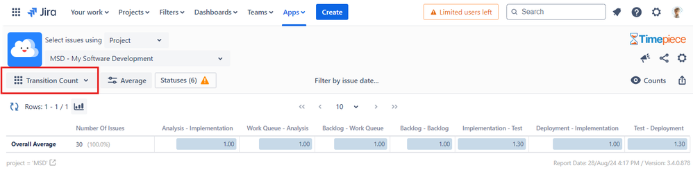

Hello @jira_admin_cu ,
It is possible to have this information through Timepiece - Time in Status for Jira
You can use Transition Count report and as a report option if you choose the average you will get your desired report.
