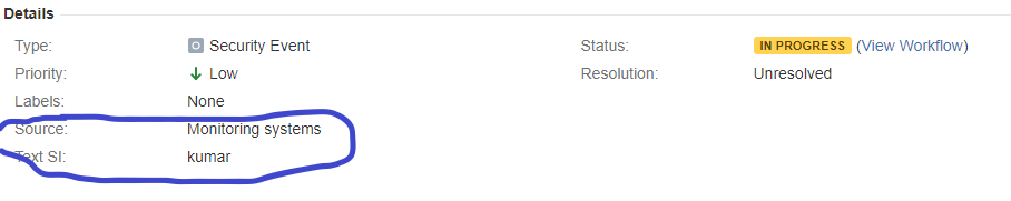

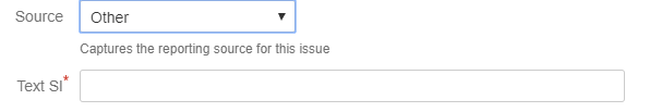

 so every thing is fine now here when I select the Other option the text field is appearing and i'm entering an Text in the Text fields and i'm creating ticket .
after creating ticket when i edit the Selected List(Single Choice) field and selecting another option still the Text Field is showing.
Here i want  when i change the Select Filed the text field should be empty.

Hi @Gundlupet Sreenidhi thanks for your response so here when i select "Other" and "Ticket system" from Select list custom field the text field has to populate
the above you suggest only "Other" option so I need to add the Ticket system option in that script so how can i add that in the script can you please tell me

Hi @Gundlupet Sreenidhi I have tried the script that you have suggested  its not working actually even when i select the Other option the Text Field is not appearing
With My script That i posted earlier  with that  the drop down list when i select  "Ticket system" and "Other" option the Text field is appearing .
But when i edit the ticket and when i change the dropdown list with rest any of the option   the Text i have entered when i select "Other" is still showing
I want when i change the dropdown list the the text field supposed to disappear  automatically  see the below pics

 and please take look that pics that i attached Source 1.PNGSource 2.PNGsource 3.PNGthe Text filed should appear only when i select Ticket system and other option so if i gave any text in text filed even after when i edit the source to email option the text is still showing
sorry for repeating same thing i just want to make sure that you got my point that's it

Hi @Gundlupet Sreenidhi now its working great and after creating ticket also when i changed source with other option the text field is disappeared with text
