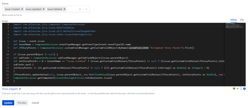

Hello,
My issue is accumulate the Sub-Task Estimated Story Points  to the Parent Estimated Story Points field and we are using jira server.
However by using scriptrunner listener created the script but that the  script only sums up the  Sub-Tasks Estimated Story Points and does not calculate the Parent one.
As an example:
If parent had 3 Estimated Story Points and Sub-Task-1 had 5 Story Points and Sub-Task-2 had 6 Story Points, then normally 3+5+6=14 story points are calculated and listed in parent Estimated Story Points field , but our current script only calculates Sub-Tasks 5+6=11 and this 11 is updated on Parent "Estimated Story Points" while "3" parent story points are completely gone. Please assist me in determining where I modified the script, and your assistance will be greatly appreciated. Here is the script:

Here is my screen shot how i configure the listener

Hi Siva,
You are not adding issue.parentObject.getCustomFieldValue(cfStoryPoints) to intStoryPoints before updating in the listener.
Kindly do that and it should start working as expected.
