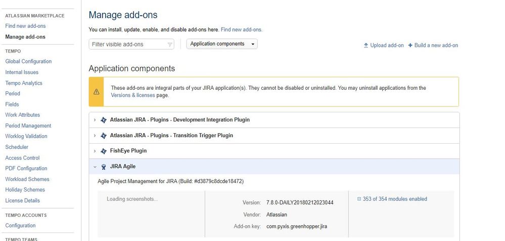

Is the above module enabled ?

all the modules in JIRA agile are enabled
Vickey Palzor Lepcha
March 15, 2018
Go to Add-Ons - select application components - select jira agile - under that check if module name " Planning Board Menu Item"   is enabled .

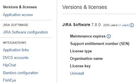

Does it show installed ?
Anup Vijayaraghavan
March 15, 2018
Yes it does.

Go to applications and check if jira software is installed
