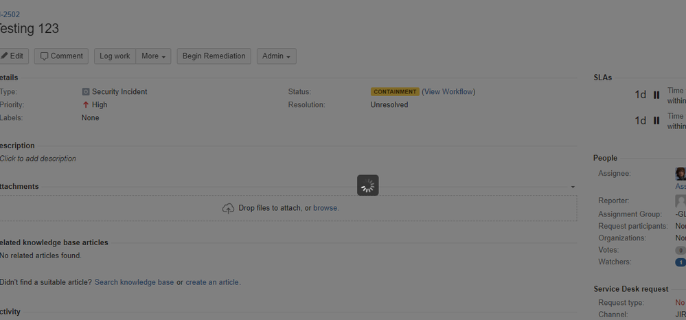

The Create/Edit Screen not popping When I open a Project / Issues its showing page loading
Kumar
November 20, 2018
HI Team,
this is happening only when i open a projects and issues and when i right click on create and edit and open in new tab its working
when i click directly its not working as shown in screenshort attached

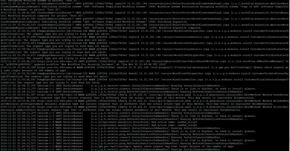

Hi @Nic Brough -Adaptavist-  Its just loading that it not showing any error message create.PNGLike this this what showing but its not loading
atlassian-jira.log:
2018-11-20 20:57:08,492 PsmqAsyncExecutors-job:thread-32 WARN p245986 1257x14758x1 1epwjl4 10.31.251.146 /secure/WorkflowUIDispatcher.jspa [c.a.s.p.a.modules.ruleif.CustomerVisibleStatusChangeIfCondition] The request type you are trying to view does not exist.
2018-11-20 20:57:12,283 PsmqAsyncExecutors-job:thread-33 WARN p245986 1257x14728x1 1epwjl4 10.31.251.146 /secure/CreateIssueDetails.jspa [c.a.s.p.a.modules.ruleif.CustomerVisibleStatusChangeIfCondition] The request type you are trying to view does not exist.
2018-11-20 20:57:14,389 PsmqAsyncExecutors-job:thread-34 WARN p245986 1257x14758x1 1epwjl4 10.31.251.146 /secure/WorkflowUIDispatcher.jspa [c.a.s.p.a.modules.ruleif.CustomerVisibleStatusChangeIfCondition] The request type you are trying to view does not exist.
2018-11-20 20:57:18,330 PsmqAsyncExecutors-job:thread-35 WARN p245986 1257x14728x1 1epwjl4 10.31.251.146 /secure/CreateIssueDetails.jspa [c.a.s.p.a.modules.ruleif.CustomerVisibleStatusChangeIfCondition] The request type you are trying to view does not exist.
2018-11-20 20:57:23,696 PsmqAsyncExecutors-job:thread-37 WARN p245986 1257x14818x1 1epwjl4 10.31.251.146 /secure/WorkflowUIDispatcher.jspa [c.a.s.p.a.modules.ruleif.CustomerVisibleStatusChangeIfCondition] The request type you are trying to view does not exist.
2018-11-20 20:58:14,959 https-jsse-nio-443-exec-18 INFO p245986 1258x14911x1 1epwjl4 10.31.251.146 /secure/admin/workflows/PublishDraftWorkflow.jspa [c.a.jira.workflow.OSWorkflowManager] User 'p245986(p245986)' updated workflow 'New WorkFLow For Security Incident' at 'Tue Nov 20 20:58:14 UTC 2018'
2018-11-20 20:59:24,497 PsmqAsyncExecutors-job:thread-39 WARN p245986 1259x15042x1 1epwjl4 10.31.251.146 /secure/WorkflowUIDispatcher.jspa [c.a.s.p.a.modules.ruleif.CustomerVisibleStatusChangeIfCondition] The request type you are trying to view does not exist.
2018-11-20 20:59:47,382 PsmqAsyncExecutors-job:thread-41 WARN p245986 1259x15042x1 1epwjl4 10.31.251.146 /secure/WorkflowUIDispatcher.jspa [c.a.s.p.a.modules.ruleif.CustomerVisibleStatusChangeIfCondition] The request type you are trying to view does not exist.
2018-11-20 21:07:00,367 PsmqAsyncExecutors-job:thread-43 WARN j288364 1267x15739x1 6vxz6j 10.31.194.215 /secure/CommentAssignIssue.jspa [c.a.s.p.a.modules.ruleif.CustomerVisibleStatusChangeIfCondition] The request type you are trying to view does not exist.
2018-11-20 21:15:01,831 Caesium-1-1 INFO anonymous Backup Service [c.a.j.bc.dataimport.DefaultExportService] Data export completed in 1828ms. Wrote 137453 entities to export in memory.
2018-11-20 21:15:01,832 Caesium-1-1 INFO anonymous Backup Service [c.a.j.bc.dataimport.DefaultExportService] Attempting to save the Active Objects Backup
2018-11-20 21:15:16,074 Caesium-1-1 INFO anonymous Backup Service [c.a.j.bc.dataimport.DefaultExportService] Finished saving the Active Objects Backup

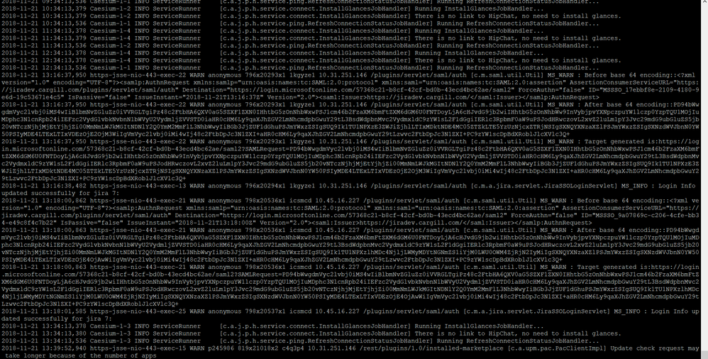

HI @Nic Brough -Adaptavist- here is the log from intstall directory "catalina.2018-11-21"
21-Nov-2018 03:49:02.689 INFO [http-nio-8080-exec-16] org.apache.coyote.http11.Http11Processor.service Error parsing HTTP request header
Note: further occurrences of HTTP header parsing errors will be logged at DEBUG level.
java.lang.IllegalArgumentException: Invalid character found in method name. HTTP method names must be tokens
at org.apache.coyote.http11.Http11InputBuffer.parseRequestLine(Http11InputBuffer.java:462)
at org.apache.coyote.http11.Http11Processor.service(Http11Processor.java:667)
at org.apache.coyote.AbstractProcessorLight.process(AbstractProcessorLight.java:66)
at org.apache.coyote.AbstractProtocol$ConnectionHandler.process(AbstractProtocol.java:802)
at org.apache.tomcat.util.net.NioEndpoint$SocketProcessor.doRun(NioEndpoint.java:1410)
at org.apache.tomcat.util.net.SocketProcessorBase.run(SocketProcessorBase.java:49)
at java.util.concurrent.ThreadPoolExecutor.runWorker(ThreadPoolExecutor.java:1142)
at java.util.concurrent.ThreadPoolExecutor$Worker.run(ThreadPoolExecutor.java:617)
at org.apache.tomcat.util.threads.TaskThread$WrappingRunnable.run(TaskThread.java:61)
at java.lang.Thread.run(Thread.java:745)
21-Nov-2018 13:16:40.744 WARNING [https-jsse-nio-443-exec-10] com.sun.jersey.spi.container.servlet.WebComponent.filterFormParameters A servlet request, to the URI https://jiradev.cargill.com/rest/activity-stream/1.0/preferences?_=1542806200788, contains form parameters in the request body but the request body has been consumed by the servlet or a servlet filter accessing the request parameters. Only resource methods using @FormParam will work as expected. Resource methods consuming the request body by other means will not work as expected.
21-Nov-2018 13:18:08.012 WARNING [https-jsse-nio-443-exec-1] com.sun.jersey.spi.container.servlet.WebComponent.filterFormParameters A servlet request, to the URI https://jiradev.cargill.com/rest/activity-stream/1.0/preferences?_=1542806287955, contains form parameters in the request body but the request body has been consumed by the servlet or a servlet filter accessing the request parameters. Only resource methods using @FormParam will work as expected. Resource methods consuming the request body by other means will not work as expected.
Please find look at it
Thanks,
Kumar

This Exact Error is when you Open a project or Open An issue from project.
when I try to click on Create or Edit button the page loading is showing but Page is not loading I have waited like 5min 10 min 15min still its showing loading.
when i disable the scriptrunner add-on when i check every thing is working fine.
Thnaks,
Kumar

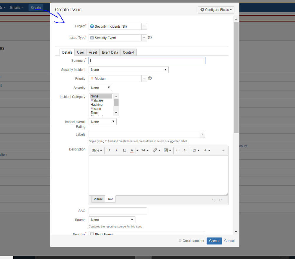

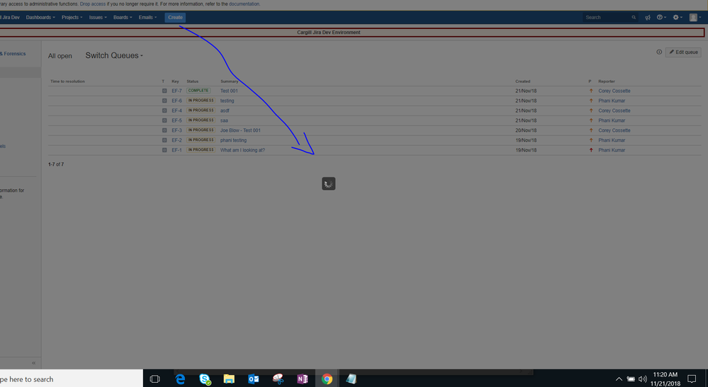

The thing is When i Open a project If you click direct Create button that show on top Bar the page is loading even if i wait for 15min its says same thing the page is loading image.
And When you open a ticket in project when you try to Click on Edit its says same thing te page is loading
If you click from dash board its popping the screen in 2-3 sec. When i Try from projects only its not working and this is happening to every project.
When i Disable the add-on then its working.
