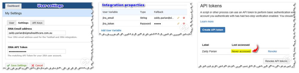

I have set up both Integration and User settings as per the documentation for API token-based authentication. But the token is never use as per the attachment.
Btw, my email is also the backup email as I'm the administration for both TestRail and Jira. Would that be an issue?

No, having the same JIRA email as the fallback should not be an issue.
It looks like you're doing all the right things. The only other thing I can suggest is to double check the email is correct and exactly the same as the one on your JIRA profile and that the other plugin configuration details are correct. If all of that fails maybe try with different credentials (a colleague etc.)

I was able to fix this by....
1. check if the user have another account.
2. delete the extra account
3. ask the user to logout
4. revoke the api token
5. regenerate the token
6. ask the user to re-login and check the integration between TestRail and Jira
Hope this help others in the future.
