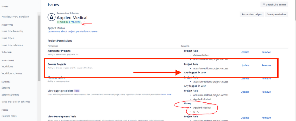

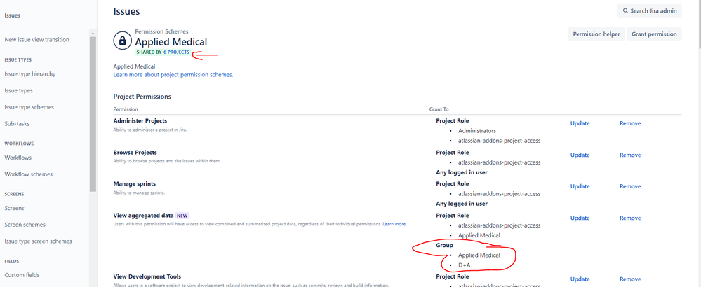

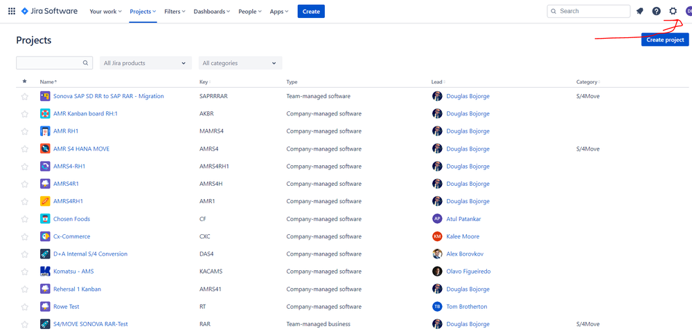

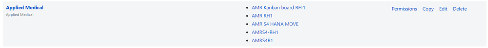

so as you can see. the user is viewing all the project and not only one
scheme.PNGpermision.PNGuser who can see allthe project. I only want  him to see just 1.PNG

You have not modified the Permission Scheme correctly.
A project can be seen based on the Browse Projects permission. In the image you provided, that permission is granted to "Any logged in user"
Any user that can log in to Jira will be able to see the 6 projects that use that Permission Scheme.
You have to remove "Any logged in user" from the Browse Projects permission, and give that permissions to specific User Groups (or to Project Roles for those projects) that contain the users that should be able to see those 6 projects.
