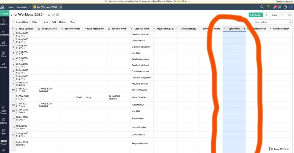

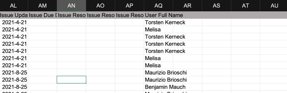

I am trying to use this link:
https://jira.company.de/plugins/servlet/tempo-getWorklog/?dateFrom=2021-01-01&dateTo=2021-12-31&format=excel&addIssueDetails=true&tempoApiToken=secretToken
to export the worklogs: it is working
The problem is that the epic links are not exported with the data
so I need help please. The data till the 8th or 9th column is exported perfectly but after that all columns are empty. is it maybe a limit in the export?

Hi @Jad Taha ,
Can you please check if the "Epic Link" has been marked to be included in the export?
To do this, please go to JIRA Administration, Mange apps, Tempo - Custom fields.
Please take also a look at the Custom Fields Configuration documentation for more information.
