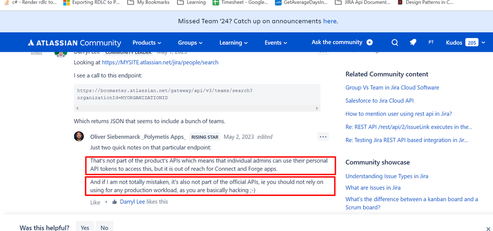

Are you trying to get the list of Teams that have been defined within the Jira Cloud product, and can be used in the Team field? If so, it doesn't appear that there is currently a public API for getting a list of all Teams. This is the documentation I found:
https://developer.atlassian.com/platform/teams/rest/v1/api-group-teams-public-api/#api-gateway-api-public-teams-v1-org-orgid-teams-teamid-get
The following post mentions an internal api endpoint that could be used. Note though that this is not a public endpoint and is therefore unsupported.
https://community.atlassian.com/t5/Jira-questions/How-to-get-all-Teams-in-JIRA-via-the-cloud-rest-api/qaq-p/2347367

Oliver Siebenmarck _Polymetis Apps_
May 8, 2024
Hey, I'm in that screenshot! So, it's been a year since then and @Trudy P Claspill has correctly pointed out that there now is an official API you can call.
Unfortunately for you and your use-case, the official API is at the org-level and thus not meant to be consumed by Connect or Forge apps. If you want that kind of access, you should open a feature request.
In the original post, I also mentioned GraphQL. Since then, I have warmed up to GraphQL – it's fantastic, albeit a bit verbose. If you are building a Compass app, I believe you can use:
CompassCatalogQueryApi.searchTeams
to look for teams. Apart from that, I currently wouldn't know where to look.
