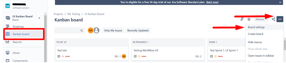

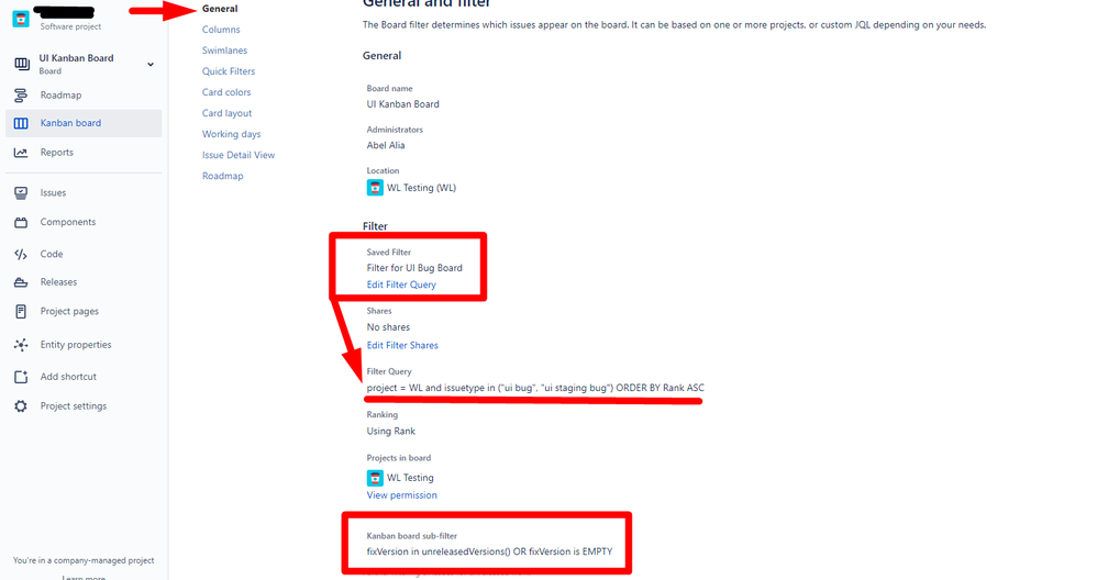

If you are a board admin kindly double check the board filter settings. Tickets that will show on the board are tickets that are returned by the board filter. Note: The screenshot is from a Kanban Board but should be similar if you are using a Scrum Board.
Most likely the filter does return newly created issue.  Example screnario, the newly created issue does not have an assignee and the board filter JQL: project = "Sample Project" and Assignee is not Empty
If you are using a Kanban board please check the kanban subfilter as well.

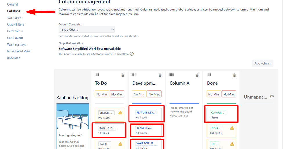

I'm guessing it could be the mapping of the status on the columns. Board Settings -> Columns. What is the status of the newly created issue? Is this status mapped to the columns of your Board? Find the newly created status and drag it to any of the columns. If the status is in the backlog you can drag and drop it to your other columns. Depending on your board, newly created issues can be configured to go directly to the board columns or the board backlog.
