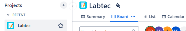

Hello!
I have several task disapearing from the board despite noe being finished or aything like that. They appear on the "list" but not on the board". If I go on the "list" and change the status and then put it again on the previous status, then the task appears again on the "board" but it gets impossible when it comes to multiple tasks.
Any solution for this? Also, no filters applied!
Thanks in advance!

Tiago Ribeiro
August 21, 2024
@Manoj Kumar Gangwar Thanks for your answer!
How can I go to the board configuration? I've searched about it but it seems different from what i'm looking for.
I mean this board and list, as you can see in the picture below.
Manoj Kumar Gangwar
August 21, 2024
This configuration applicable on the jira software boards but as per your screenshot you are using JWM so please go with @Bill Sheboy suggestions.
