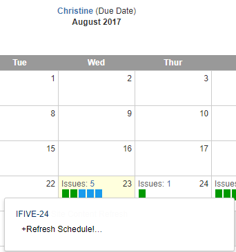

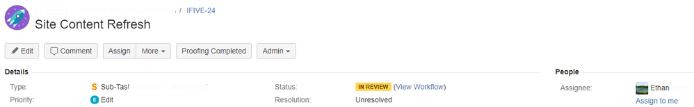

I've added some screenshots. This task should be assigned to Ethan but Christine still sees it in her queue and even in the list view is says that she is still the assignee which is not the case when looking within the task itself!

Task history says she changed it, and it is reflected inside the task. Just not in any gadgets.

An additional tidbit, I went into the task that Christine was asking about. I assigned it to myself and then back to him and that fixed the issue.....any ideas???
