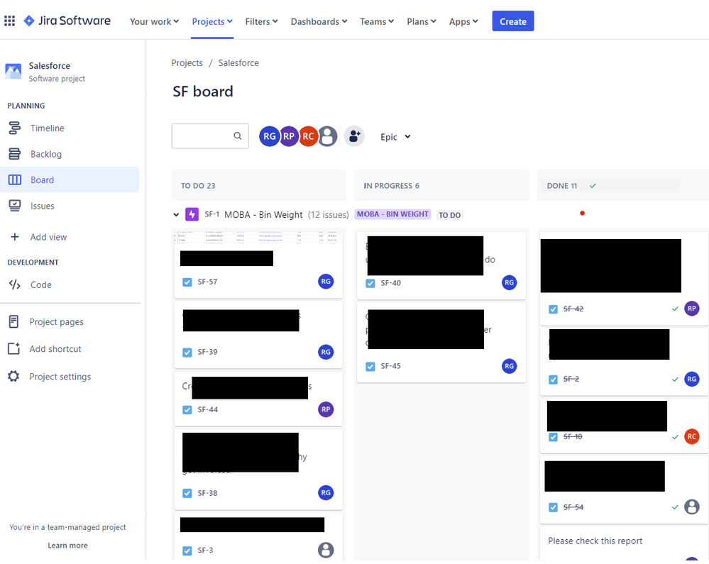

Hi, I have a really simple project
a workflow of 3 (To do, In progress and Done)
I have no filters
I was using it fine yesterday, creating epics and tasks using the top create button and tasks were showing on the board
Today however something has changed, I created a new epic and it was added to backlog but not the board
I created a new task and again it was not added to the board.
When I create both a task and epci i get this message: "For issue SF-62 to be visible, it must match your project and filters, and have a status that’s assigned to the board."
However it is in the project, I have no filters at all and the status is the standard out of the box To Do (and the kanban board is the standard out of the box kanban board.
Very frustrating

Hello @Richard Grinter
I see that you are working with a Team Managed project, with a Kanban board and you have the Backlog feature enabled.
Have you checked the Backlog screen to see if the issues are displayed there?
 Additionally, view one of the new issues and check the status to which it is set. What is that status? Next click on the three dots button in the upper right corner and select Configure Board. The click on the Columns option. Confirm that all statuses are mapped to a column and none are in the Unmapped Statuses area.

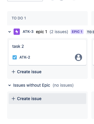

When I am viewing the Kanban Board of a Team Managed project, and the Backlog feature is enabled, and I click the blue Create button, then the new issues I create are automatically put in the Backlog rather than on the board.
However if I instead use the +Create Issue button at the bottom of the To Do column, then the issue is added directly to the board.
I can't really say if it worked differently yesterday because I don't work with Team Managed projects every day. But I think this is how it has been working.
If you don't have the Backlog feature enabled, then the issues would automatically display on the board regardless of how you create them.
Did you newly enable the Backlog feature since yesterday?

hmm, it might be that one of my team members did enable backlog yesterday
ah I have now spotted the add to board option in the backlog.
thanks for your help, it doesn't work exactly how i'd like but i think i know what to do now, I appreciate you taking the time.
