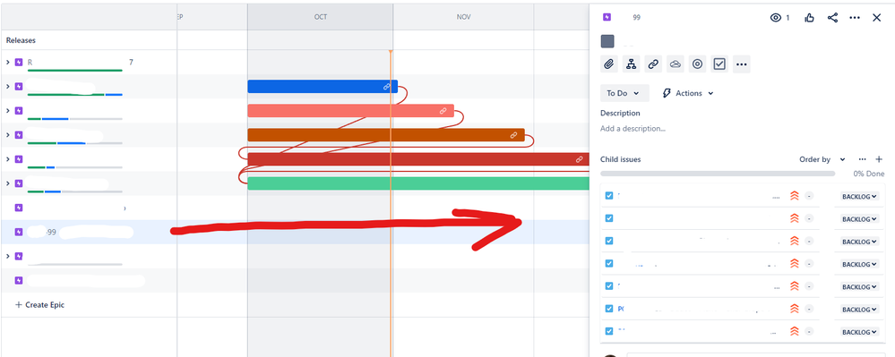

Pessoal, normalmente quando criam os epicos, as atividades vinculadas aparecem na timeline.
Foram criados alguns epicos e adicionaram historias e tasks atraves do epic link. Quando clico no epico, as historias aparecem, porem na time line, elas não aparecem. Alguem consegue me ajudar?

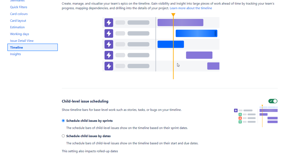

Hi @Ana Vitoria and welcome to the Community!
Can you check your board settings and under the timeline tab make sure that Child level issue scheduling is enabled?
2023-10-31 13_49_02-CMSD board - Agile Board - Jira.pngHope this helps!
Ana Vitoria
October 31, 2023
Hi @Walter Buggenhout ! Thank you for the help :) It is enabled.. There are some epics on that same timeline that shows the child, but others do not.. Captura de tela 2023-10-31 095618.png
Walter Buggenhout
October 31, 2023
Are these tasks in the same project as your epics?
Ana Vitoria
October 31, 2023
They're not in the same project.. Maybe that's why. Are there any solution in this case?
Walter Buggenhout
October 31, 2023
That is indeed why. The (basic) timeline can only display issues from 1 project. If you want to build timelines with issues from multiple projects you would either need to upgrade to a premium plan, where Advanced Roadmaps does offer this capability, or check the marketplace for solutions compatible with the standard plan. Structure by Tempo is one that comes to mind.
