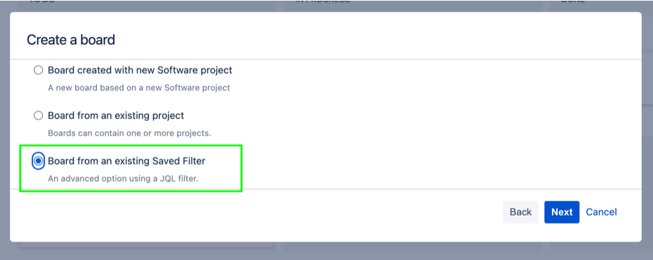

Hi @Lisa Brogan ,
- If it was a software project, then it could be done with a kanaban or scrum boards with use of saved filters for team specific tasks.
- Other way might be going 1 lvl above and create epic which is cross project, then create tasks under epic for specific teams in their dedicated project

Build some dedicated dashboard with filtered results for dedicated teams. You can organize it with columns as it would look in the kanban project. Just remember to double check if all users can see tickets, which they should see (or act on)
