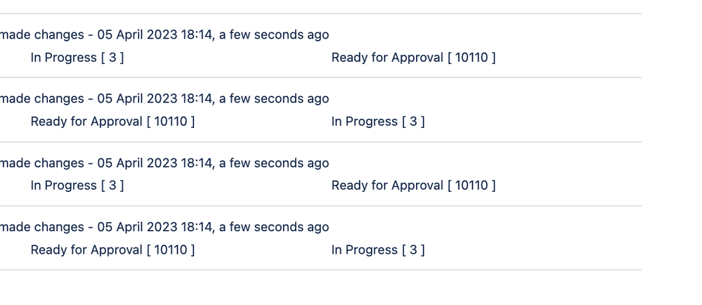

I compare the 2 stats with /rest/api/2/search?jql=key=PLAYRTS-5145 if the goal has changed but nothing is different. They have the same sprint goal link
Maybe I can ask the value in DB to check the real stats...
There's no point looking in the database, it's not going to tell you more than the UI does, and it's a right royal pain to find too.

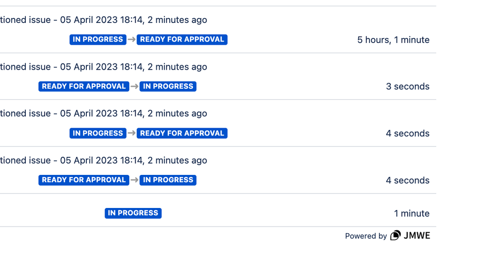

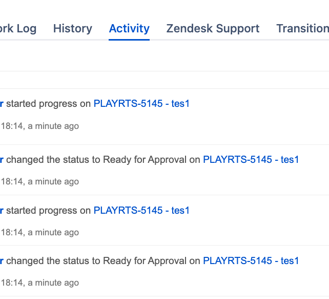

My next step would be to look in the issue history - what fields is it recording as changing when you change status or edit it? And when the problem occurs, look around your changes - is the history recording any ranking or sprint changes around your edits (within a couple of minutes either side)?
You're not giving it long to complete the transitions and refresh there.
But it still looks like you have something ranking it at the bottom of the backlog (i.e. outside the current sprint) when you transition it.
Usually, when it goes to the backlog is when its change to a status that is mapped to the backlog. If the status matches to a status that's mapped to the backlog, that is correct behavior. If that's the case, would check the ticket history and check any workflow automation that may have contribute to this issue.
