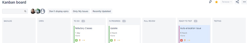

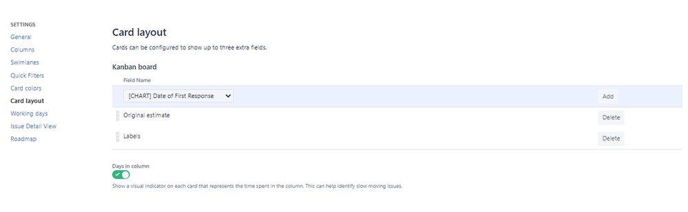

I´ve installed it, but which field I should add in order for the sum to be displayed for the Kanban board? I´ve added the 'Original estimate' field in the card layout in the board settings, but the  column sum is still 0h.
Per Lundström
May 2, 2021
Hi! Can you send an image of your board, so I can see if I can spot the error? Is it a company-managed project? :)
Hilda Correia
May 2, 2021
Hi! Sure!  Yes it´s a company-managed project =)
Per Lundström
May 2, 2021
Thank you! Oh wow, I use Σ Remaining Estimate (can be found in the bottom of the list) in my board and that prints the amount of hours and then just h instead of hours. I will have to update the extension for it to work with hours. It´s a quick fix and I will upload the new version later today, it will probably get approved by Google later this week. :)

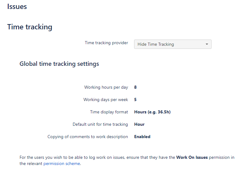

How does your Global time tracking settings look? Are the settings the same as mine? image.png
The setting can be found here: https://support.atlassian.com/jira-cloud-administration/docs/configure-time-tracking/
Hilda Correia
May 3, 2021
Heyyyyy!!!You got it!!! I think that was the issue!!! My global time was not in hour, I´ve changed to exactly like yours and now it's working!!! Yeyyy! Thank you very much for your attention and quick response Per Lundström!   =)
