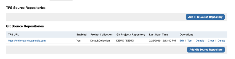

For the TFS4JIRA Settings in your Jira instance, you can only input one Synchronizer URL. You need just one Synchronizer instead of multiple Synchronizer.
Even if your Synchronizer is installed in the same machine as a TFS Server, as long as the communication between this server and another TFS Server is not blocked, you can create sync profile pointing to other TFS Server URLs.
If you are referring to workitem/issue synchronization, in sync profile, you can input different TFS instance URLs,
If you are referring to check-ins visibility, you can add different repos with different TFS URLs,

By the way, the screenshots which you sent, are those of the synzhronizer application or it is of the JIRA config page?
Thanks
Hi Pratik,
Those screenshots I have sent are in the Synchronizer itself. Basically, if you would like to connect to multiple TFS Servers, you need to make sure where you installed the Synchronizer has to be able to communicate with these TFS Servers and Jira.
