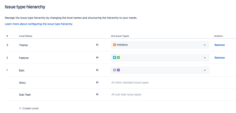

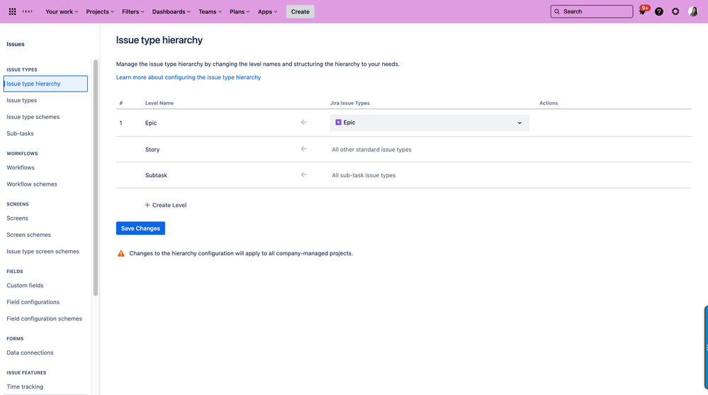

For simplicity I'm going to refer the the terminology that matches my example screen images, where the "Epic" level issue is still called "Epic" and the level above it is called "Feature"
The Issue Hierarchy configuration is managed by Jira Administrators. The screen looks like this:
This is the hierarchy that can be visualized in an Advanced Roadmap Plan.
In this example notice in the Jira Issue Types column that the Epic and Feature levels each have two icons. That means there are two types of issues that can be used at each of those levels.
So to add a level above the Epic level you need to first have an issue type created that you can place there.
Then you update the above configuration to add the level and add the issue type to it.
To then use that new issue type/level, the issue type at that level has to be available in your project.
Then you can create an issue of that type.

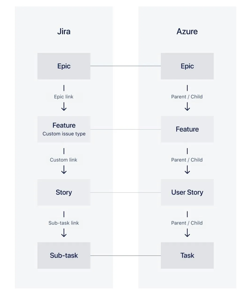

Regarding your questions, to add more information to this case, Jira only has three levels by default: Epic > Standard Issue type (Bug, Task, Story, Custom standard issuetype, etc.) > Subtasks (Subtask, Custom subtasks). In Azure DevOps, we can find multi-level hierarchies; for example, in Azure DevOps, a Task can be a parent of an Epic, and this Epic can have another Epic as its Child.

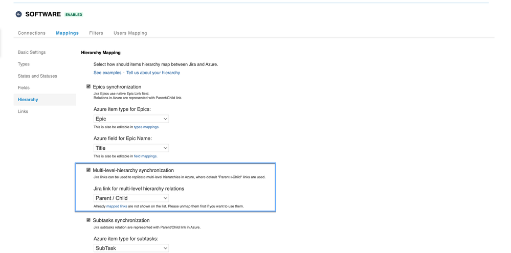

With the TFS4JIRA app, we can replicate Azure DevOps multi-level hierarchies in Jira through a Jira custom link type,

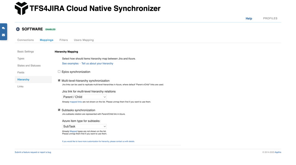

You can create this custom link in Jira by going to Settings > Issues > Issue Linking > Add.
Then, add this configuration in TFS4JIRA by going to your Profile> Mappings > Hierarchy > Multi-level-hierarchy synchronization > Select the Jira custom link created before.
After this, if everything else is already configured (types, statuses, fields, etc.) and the Profile is enabled, you can start synchronizing from AzureDevOps to Jira to test this configuration.
Here is an example of my configuration:

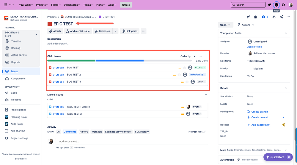

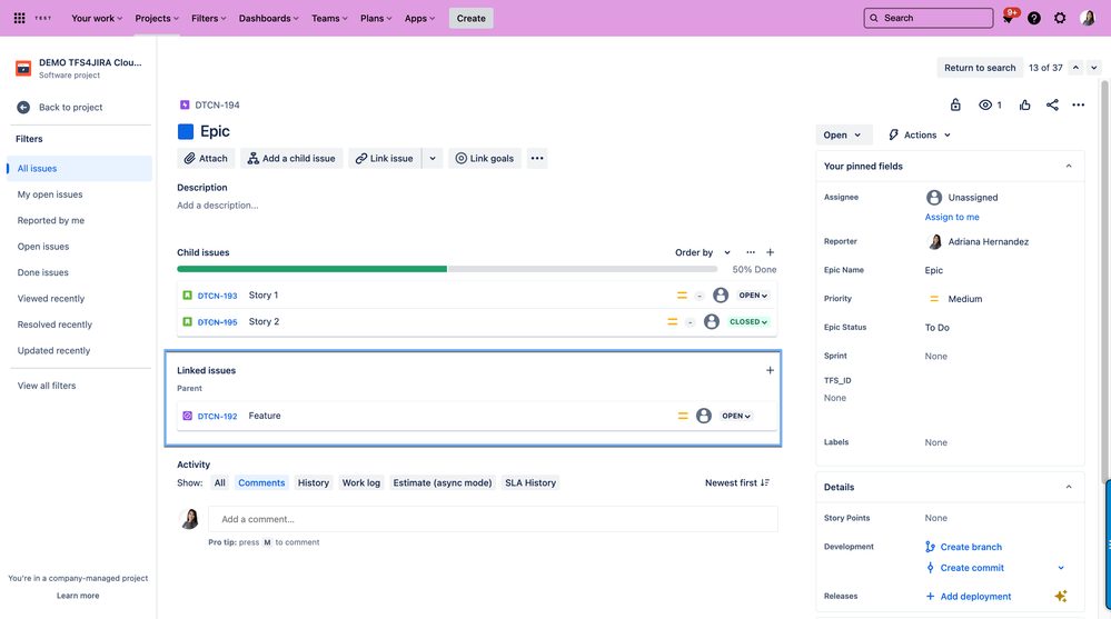

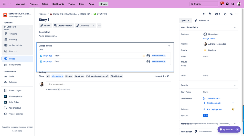

In the screenshot above (SS-3), the issue DTCN-192, a custom standard issuetype (Feature), is the parent of the Epic DTCN-194.
Here is another example:

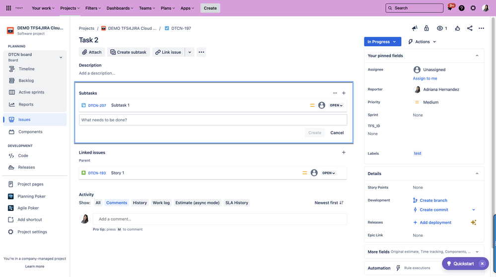

In the screenshot above (SS-4), one of the Stories from the Epic DTCN-194 has two 'Child' Tasks (standard issuetypes) DTCN-196 and DTCN-197.
Lastly, here is another example:

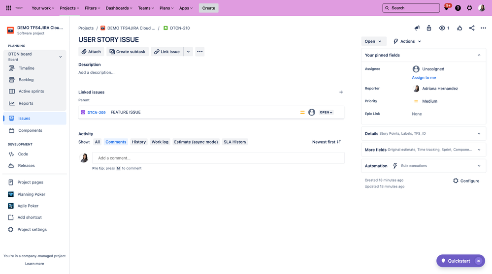

In the screenshot above (SS-5), Subtask Synchronization is also enabled in TFS4JIRA. This allows us to have another layer after the Tasks in the example before (SS-4).
Please note that for this TFS4JIRA configuration, I used the default Issue type hierarchy configuration in Jira.

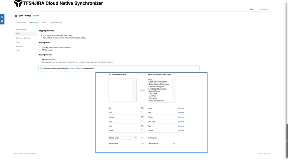

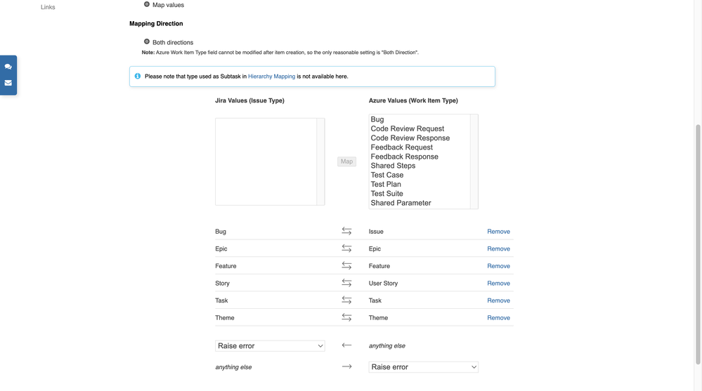

My screenshots in my last comment were just a use case example, using Epic issuetypes, Feature (a custom standard issue type), etc.
In TFS4JIRA, you can map types according to your needs, for example:
But, recall that Epics are a unique issuetype in Jira. When using the Jira Epics native configuration (Epic Link), their child issues can only be standard issue types, and the representation differs from other Jira relations.
In TFS4JIRA, you can map any Azure DevOps workitem type with the Jira Epic issuetype, and you can choose to use the native Epic Link field, which looks like this:
Or use the Jira custom link type we created before:

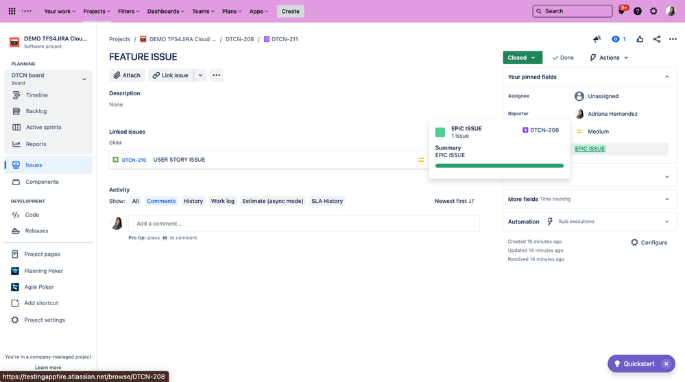

I did a test on my end. You can see the results in the following link:
video_demo_hierarchy
Let me know if you are available to see the screen recording, and also, please confirm if the hierarchy in the screen recording corresponds with your use case.
Here are the screenshots of this test:
1. TFS4JIRA configuration used

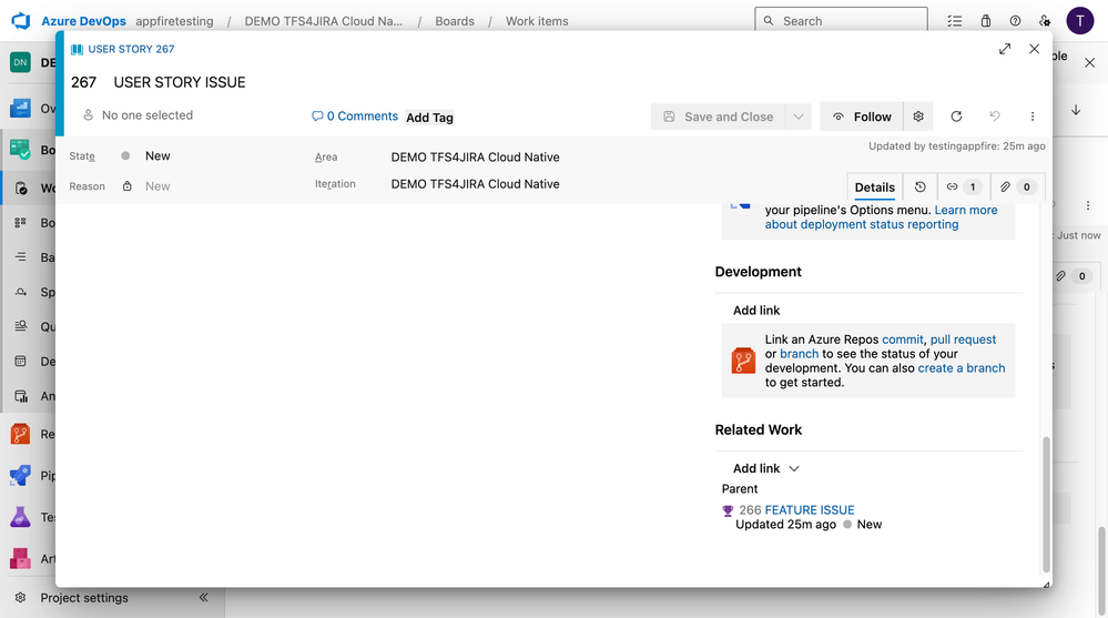

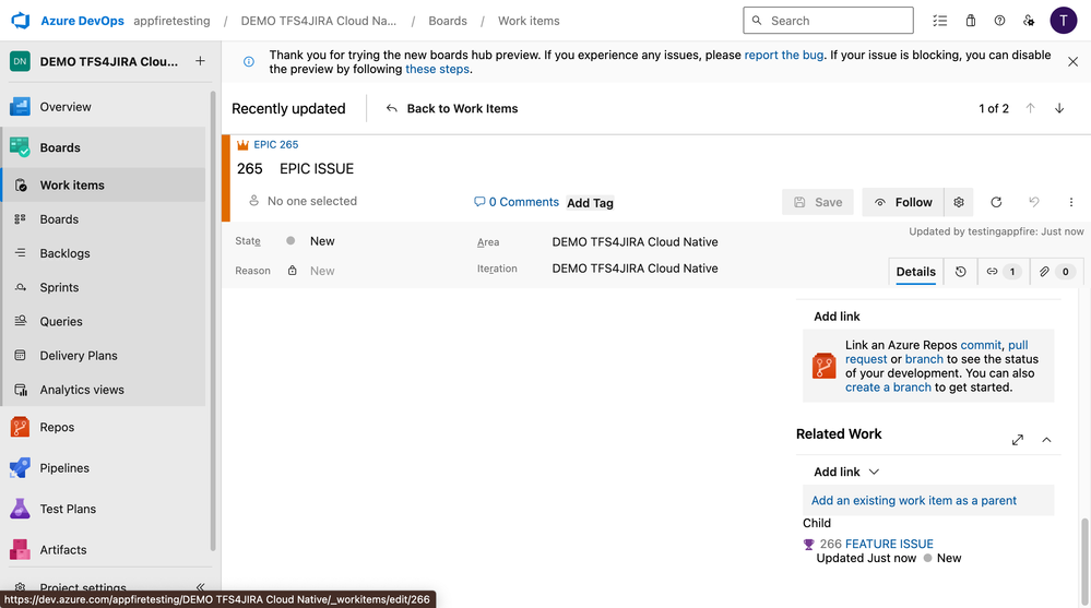

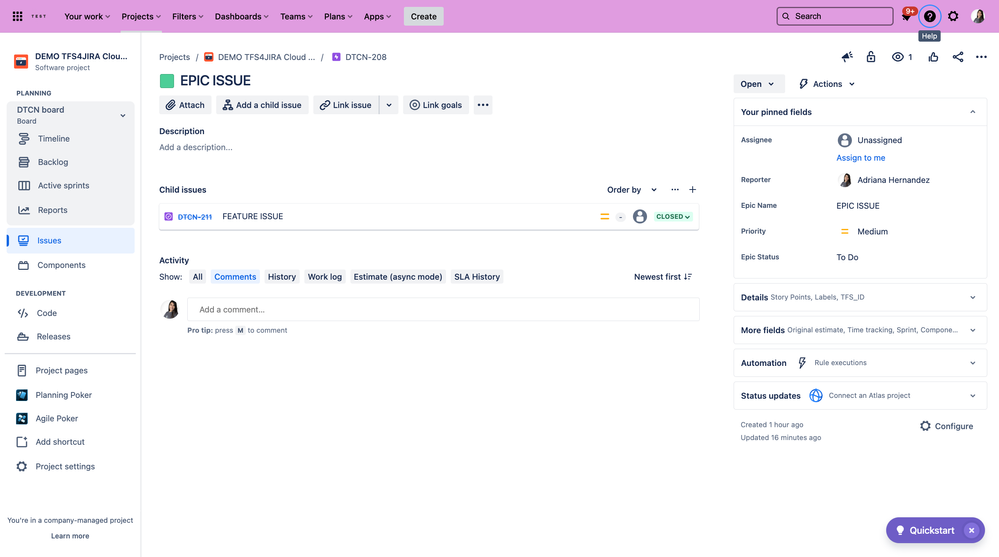

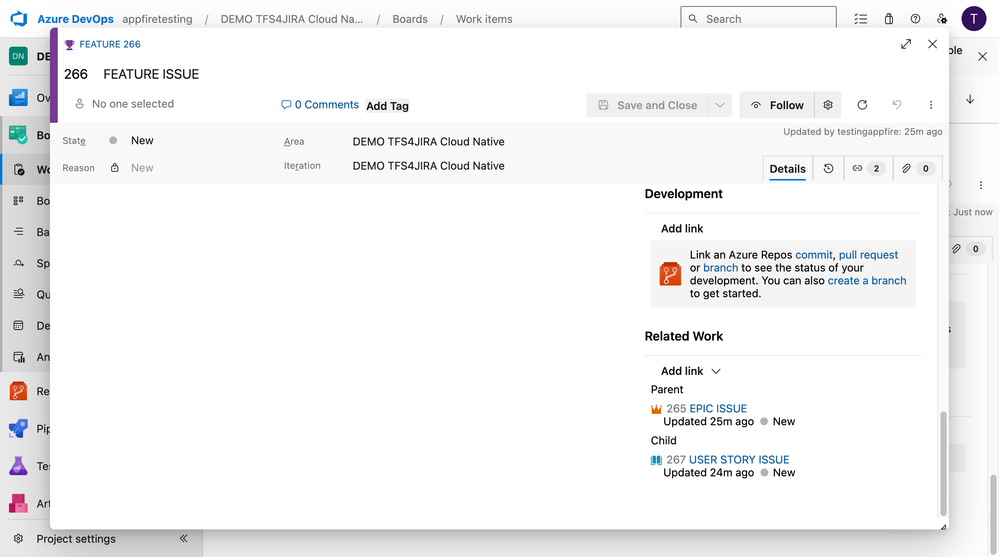

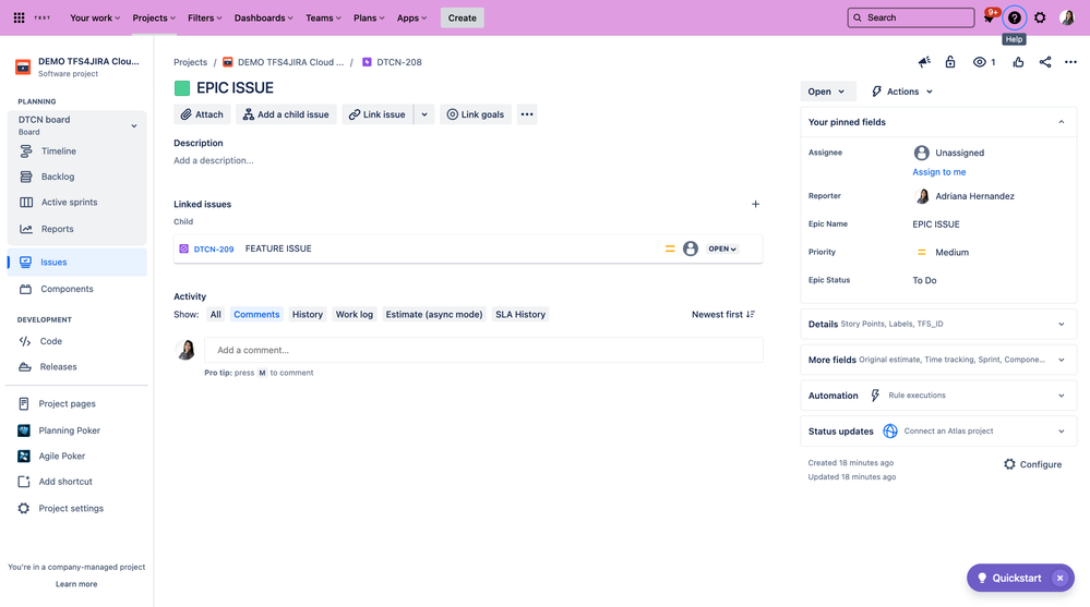

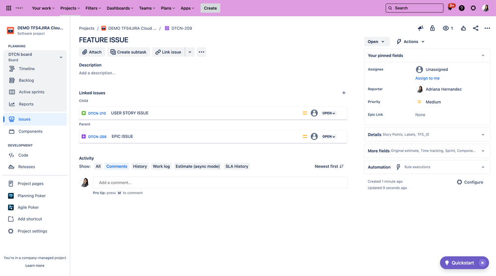

2. Creating Azure DevOps workitems and linking them: Epic, Feature, and User Story.
Screenshot 2023-10-13 at 20.13.58.pngScreenshot 2023-10-13 at 20.14.07.pngScreenshot 2023-10-13 at 20.14.12.png

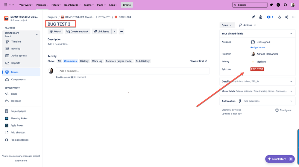

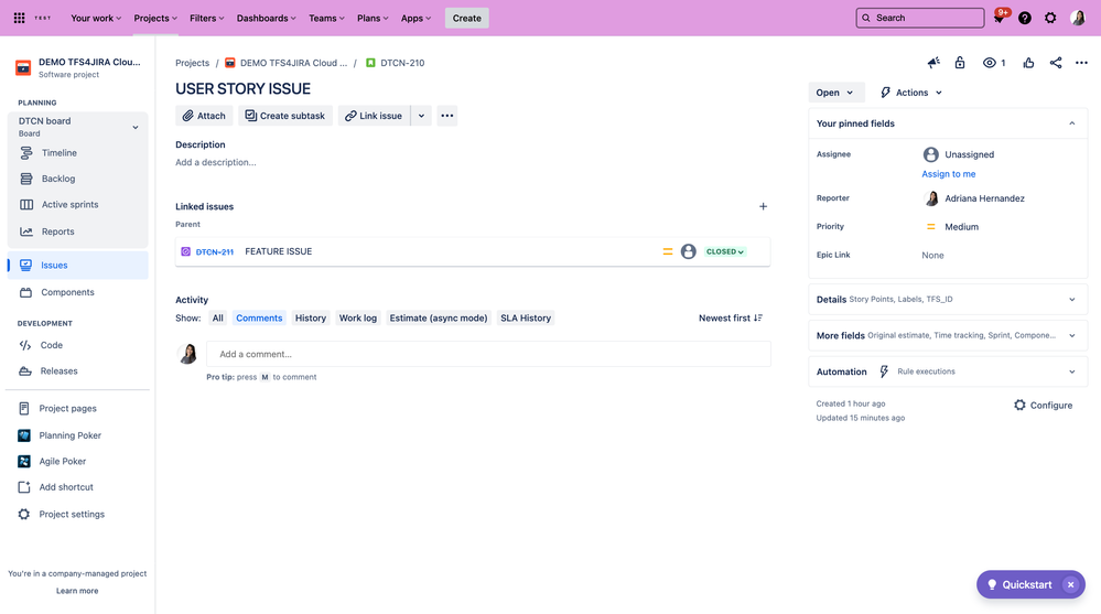

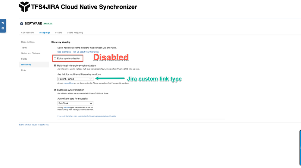

2. Jira Issues created by TFS4JIRA with the TFS4JIRA - EPICS synchronization configuration disabled.
Screenshot 2023-10-13 at 20.07.59.pngScreenshot 2023-10-13 at 20.08.06.pngScreenshot 2023-10-13 at 20.08.12.png

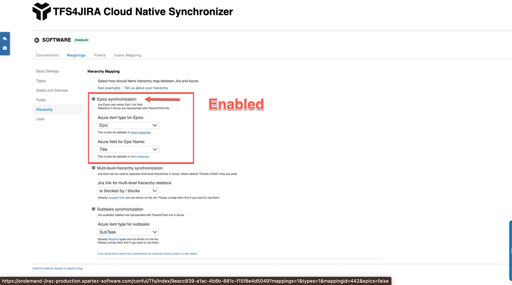

3. Jira Issues created by TFS4JIRA with the TFS4JIRA - EPICS synchronization configuration ENABLED.
Screenshot 2023-10-13 at 20.37.20.pngScreenshot 2023-10-13 at 20.37.25.pngScreenshot 2023-10-13 at 20.37.30.png
Check the screen recording below for more details related to point 3.
video_demo_hierarchy_2
This is how our customers have achieved representing the Azure DevOps multi-level hierarchy in Jira.
Please note that the custom Jira link type 'Parent-Child' that TFS4JIRA uses to represent this hierarchy is not part of the Jira built-in configurations to represent issue hierarchies at all, this means that this Jira link-hierarchy won't be visible in roadmaps or timelines. (I showed an example of the timeline view here: video_demo_hierarchy_2 .)
Also, as you can see from the previous screenshots, we can only see the parent and child links of the current Jira issue; we can't display more layers than that because this is how Jira works.
