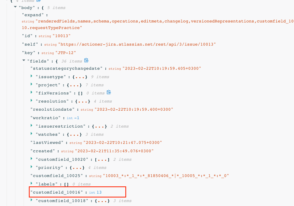

Hi @Emilia Traczyk ,
As i understand, you are trying to estimate efforts with using t-shirt sizes. You can use endpoint below
https://developer.atlassian.com/cloud/jira/platform/rest/v3/api-group-issues/#api-rest-api-3-issue-issueidorkey-get
In the returned response, the tshirt size is most likely a custom field.
Example response;

Hi @Emilia Traczyk
as @Tugba Capaci said, the t-shirt size of your issues is most likely some custom field, as this is not a built-in Jira feature.
If the t-shirt size is visible on your issue, it should also be included in "fields"; it will, however, almost certainly have a different identifier. To figure out the identifier, you can call the fields endpoint and search for the name of your field.
