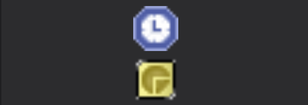

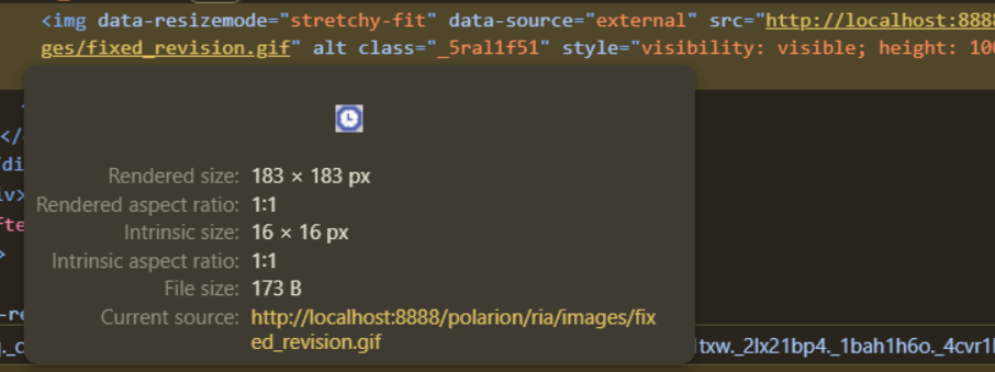

On Jira Cloud, when synchronizing Work Item (WI) links into the description from Polarion, the thumbnail icons get enlarged and render as 183px × 183px instead of the expected 16px × 16px.

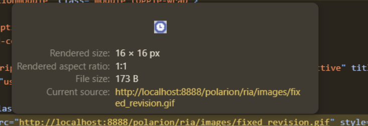

On Jira On-Premise, the same WI links display correctly at the smaller size.

  • Works correctly on Jira On-Premise (thumbnail renders 16px × 16px).
  • On Jira Cloud, the thumbnail gets enlarged (183px × 183px).
  • The rendering difference seems to come from Jira Cloud itself.
Please refer to the attached screenshot.
Jira Cloud Screenshots:
Jira On-Premise Screenshots:

Hi @Team Epsilon Admin welcome to the Community.  I took a quick look at Atlassian's Jira Site and didn't see anything specific to Polarion/Jira integration and this issue.  Is there a way to confirm the data coming out of Polarion has the appropriate image sizes?  That would help to confirm on which side the issue could be.
If the issue is actually on the Jira side of things, since you have an Enterprise license, you can interact with Atlassian Support to have them weigh in on what is going on so it could be looked at in more detail.

I have confirmed the behaviour on Polarion side, the thumbnail (image) size is correct, it works as expected for the Jira - On premise. The problem only exists for the Jira - Cloud.
