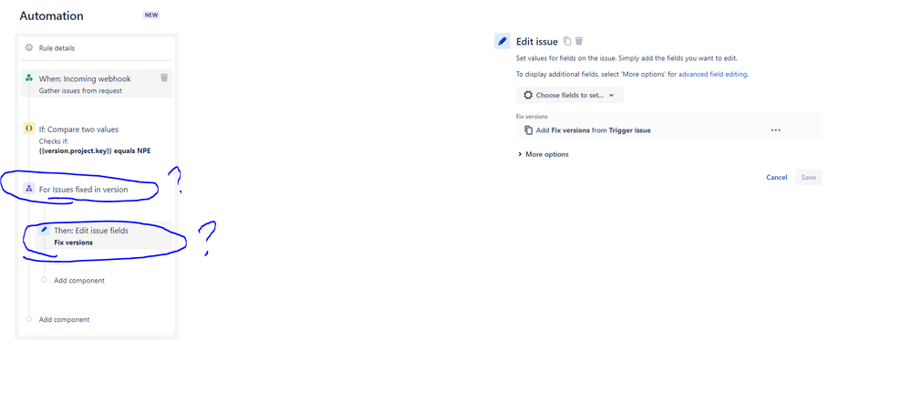

I am currently working on this and have few questions.
To setup the source webhook, I went to "webhook" in system setting. From there I created a webhook listener, is that the source of the webhook? I assume the listener is looking for any events related to version updates from the entire JIRA website? If this is not right, could you let me know how to setup the source webhook? I also don't see any webhook in project setting. Please provide guideline here.
Assuming the listener I set previous is right, now I am setting up the automation piece to pick up the incoming webhook. I am setting this automation as global automation.
1. My trigger is incoming webhook. (I take the URL from the trigger and paste it to the webhook in the source webhook, is that right?), please provide guideline here.
2. Follow by if project key = NPE.
3. Then brunch for.... (I only see issue fixed in version, isn't this is only for issues update, not fix version in projects?), please provide guideline here.
4. Then I setup new action to edit fix version.... (In here I also only see edit issue, not edit fix version in project), please provide guideline here as well.
 Capture.PNGI think I am close, and I appreciate the support!

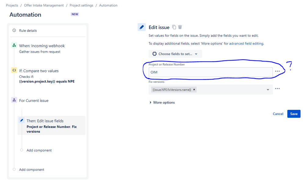

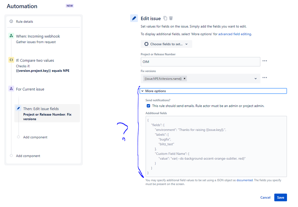

Garret Zhang
March 23, 2023
Hi @Oday Rafeh
Thank you for the response, I finally got time to come back to this. I am very close and got stuck on the very last part:
"To edit the fixed version in Project A, use the "Edit issue" action. Set the project to Project A"
Could you help me verify setting Project to OIM is correct? (OIM is the target project where fix version will need to be updated) Source project is NPE.
"use the "Advanced issue search" option to find the issue(s) that correspond to the updated version from Project B."
I am unsure on what to write in the "Advanced issue search" section.
"In the "Edit issue" action, set the "Fix version/s" field to the updated version(s) from Project B."
could you also verify if this is right? (Issues - from NPE project - look up fix version - name)
Thanks again!
