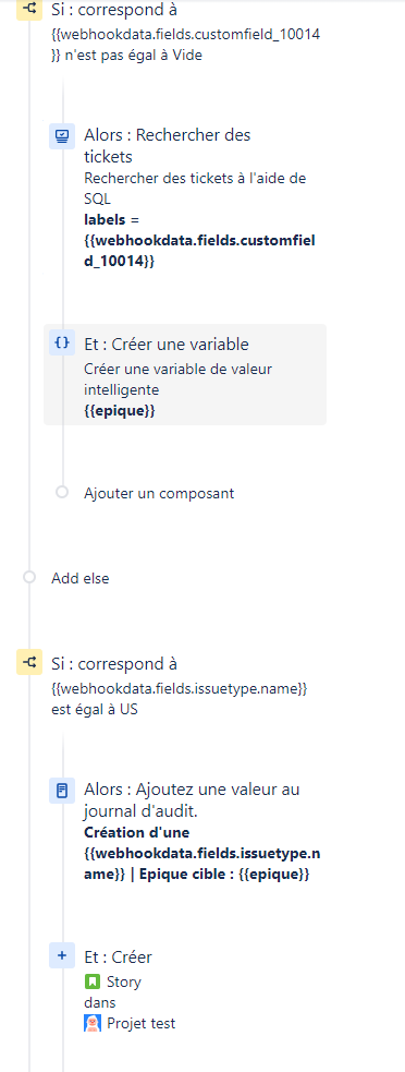

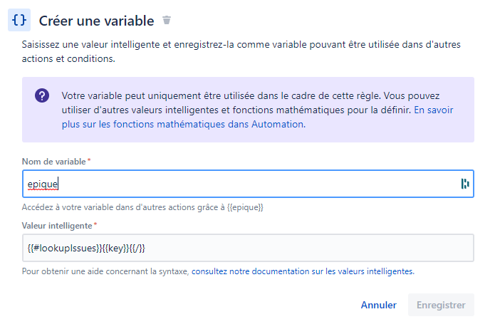

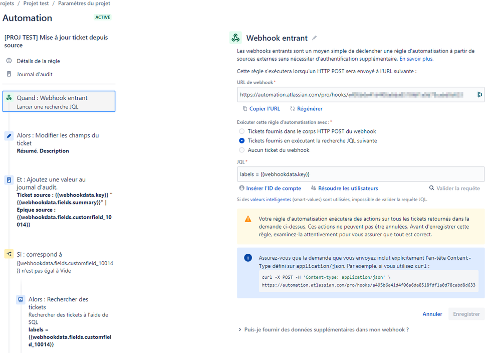

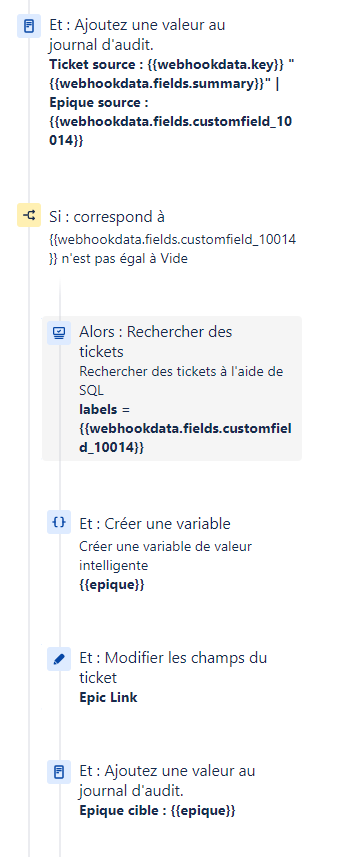

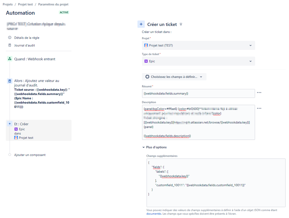

Grégory Verron
January 20, 2023
I used Jira Automation to do it.
1) Automation for Epic creation
Summary:
{{webhookdata.fields.summary}}
Description:
{{webhookdata.fields.description}}
Other fields:
I put issue key into labels and add Epic Link.
"fields": {
"labels": [
"{{webhookdata.key}}"
"customfield_10011": "{{webhookdata.fields.customfield_10011}}"
2) Automation for issue creation
3) Automation for issue update
