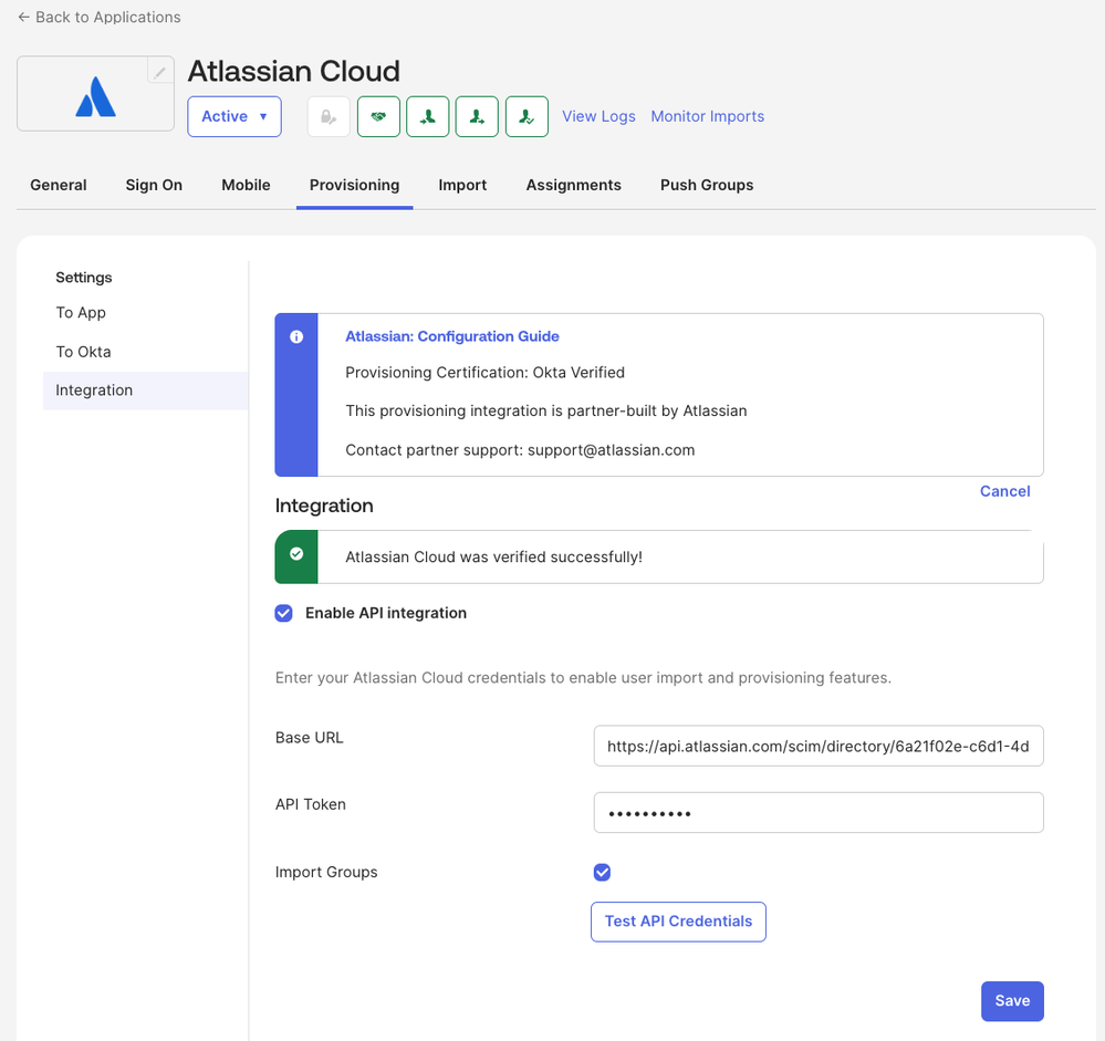

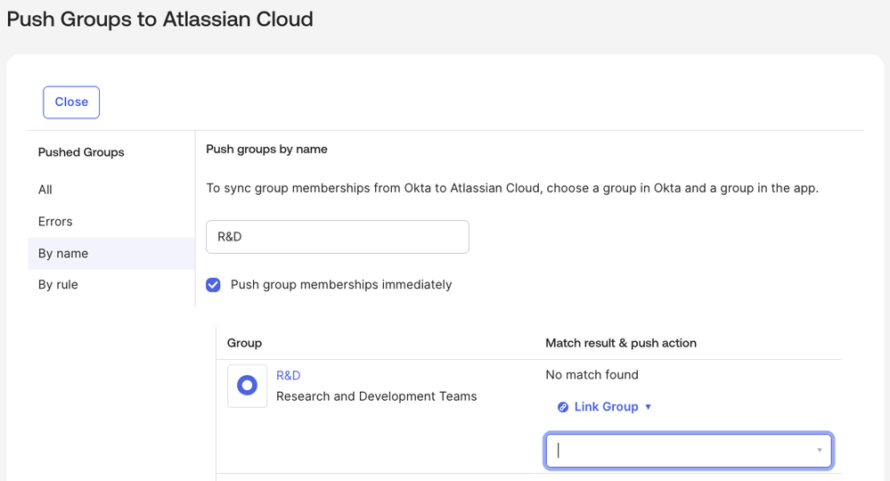

I want to sync Okta group to an existing atlassian group. However. when i reach the part where i need to pick the atlassian group in my atlassian okta app the atlassian groups are empty.
I do have API integration and SCIM enabled.

Daniel Sharouf
January 6, 2026
Yes, Also when i hit the test API integration it returns that it was successful.
