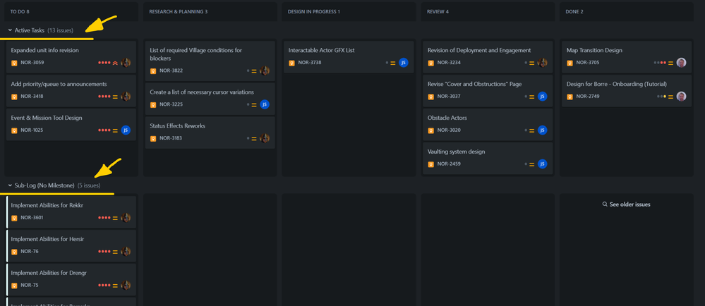

Board 1 (Works fine):

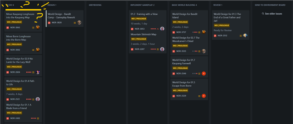

Board 2 (Does not Work):

  • Our boards are each filtered to only show one specific Issue Type.
  • Both boards have the correct Swimlane Query syntax.
  • All project Issue Type share common Fields such as Fix Version and Parent.
  • The Issues Types on both boards have Fix Version as either empty or set.
    • The white highlight color is queried: <fixVersion is empty>
  • Board 1 Issue Type does not "share" a Workflow with another board.
    • Board 2 Issue Type does "share" a Workflow with a "twin board".

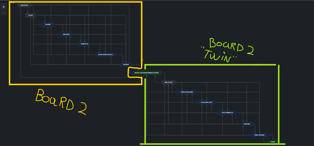

From what I've been able to assess is that this problem may have something to do with the task's Workflow. As we use staggered completion stages for certain Issue Types, they will have a set of Statuses used on one board, whereas the latter stage Statuses are on its own separate board.

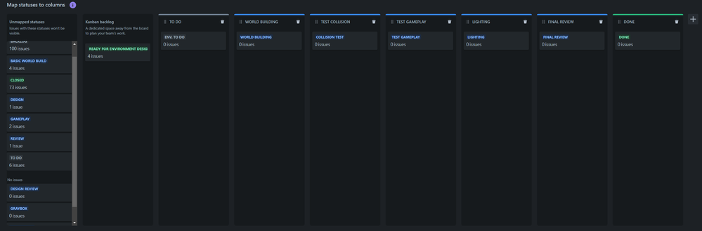

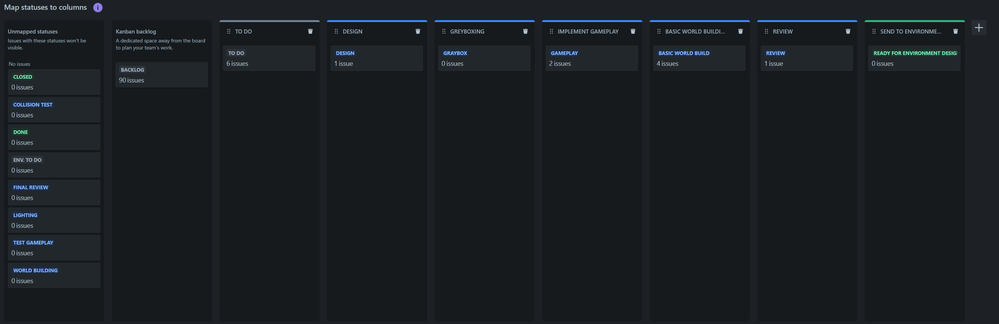

Board 2 Column+Status Setup:
  • Note: Board 2 filter does not show the Ready for Environment Design status.
Board 2 "TWIN" Column+Status Setup:

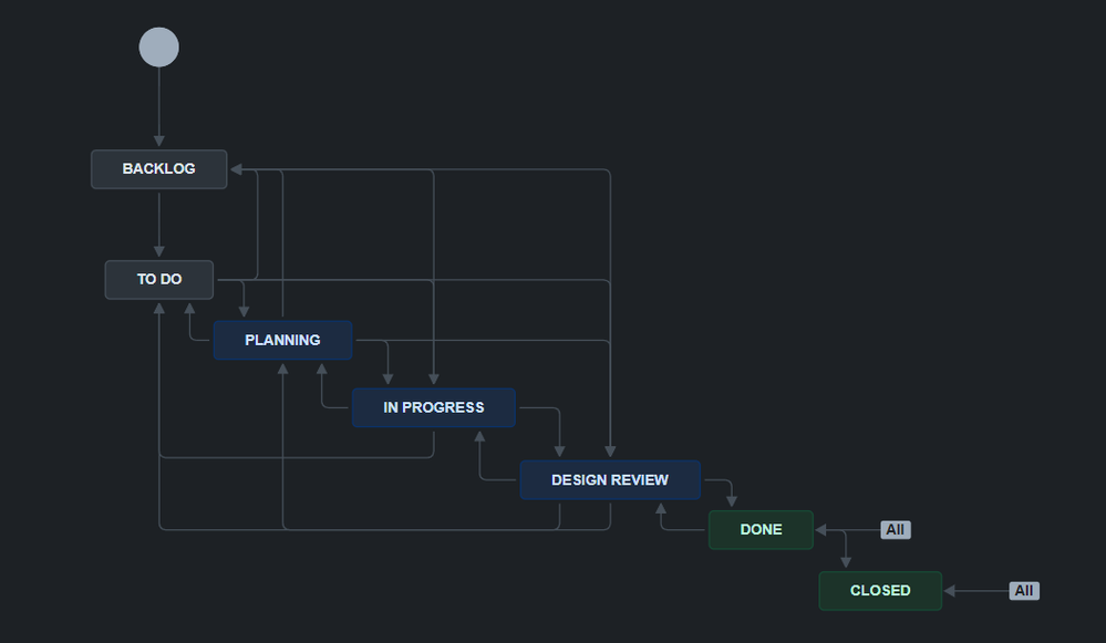

Board 1 Issue Type Workflow:
Board 2 Issue Type Workflow:
