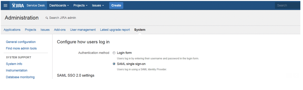

I am attaching a snapshot (pls find it as an attachment) from where they can control authentication with the SSO, the person who reported the problem, confirmed for no add-on as per his knowledge. It looks like, the offering is natively integrated into Jira.
 Let me know if you need any other informationScreen Shot 2017-12-20 at 11.39.00 AM.png

Hi @Gaurav Nigam
According to your screenshot, we're talking about Jira Data Center here are you're actually using Atlassian's SAML native connector: https://confluence.atlassian.com/enterprise/saml-single-sign-on-for-atlassian-data-center-applications-857050705.html
According to Atlassian's documentation, when you select the 'Use SAML as primary authentication' option, you can still use basic authentication. Did you check that your customer really uses basic auth to authenticate on the REST endpoint?
According to Atlassian's documentation, you can also use form-based authentication on a dedicated REST endpoint. My understanding here is that 'Dedicated' means that one of your nodes will take care of all the REST API traffic. Please read the 'REST API traffic' paragraph on this page for more information: https://confluence.atlassian.com/enterprise/traffic-distribution-with-atlassian-data-center-895912660.html
