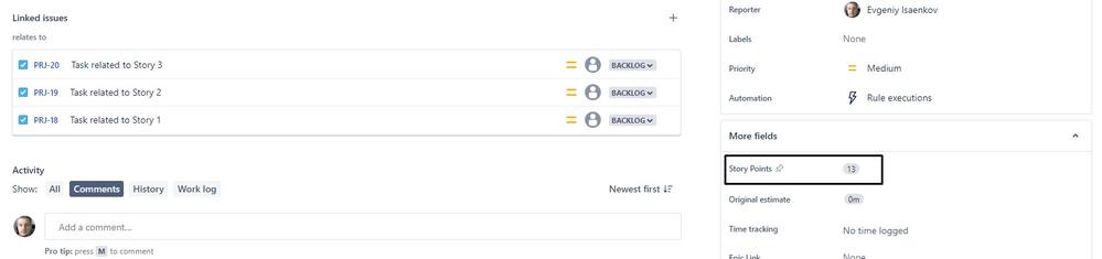

As fist step - you select Story. Only after that with "Lookup Issues" you must search for list of tasks, that relates to Story.
Take a look at this example:

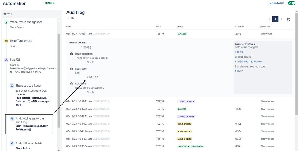

@Evgenii  didnt work, what am I missing??
The log shows success, but the story keeps showing "0" in the field:

I slightly refactored rule, to check, that it's working and changed way of setting value in field. Checked it in my environment - it works.
You can check, that values sum up correctly in log, or you can simply not add in your rule selected block, that logs value (shown on screen), it won't affect on rule.

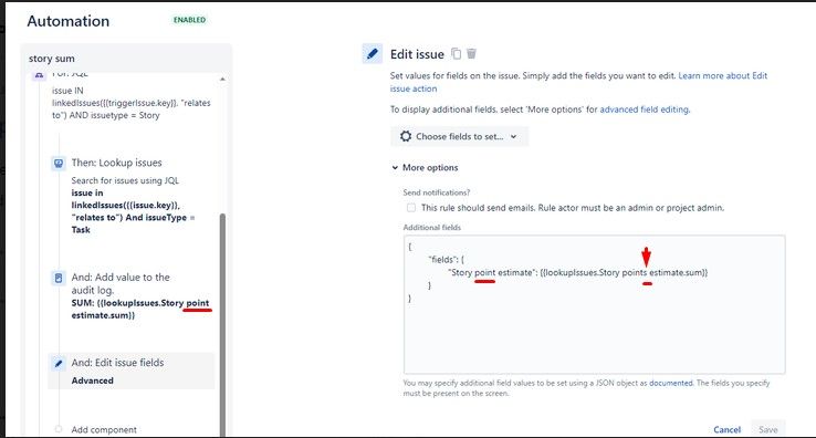

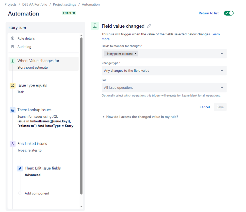

@Evgenii  so, the problem is apparently in the field from the story...

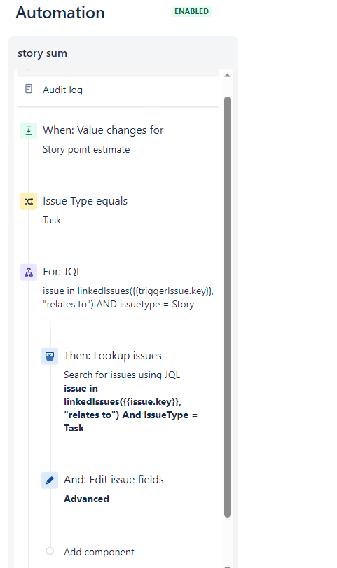

I did a small modification on your rule as I dont have have th option to select the fiels "story point estimate":

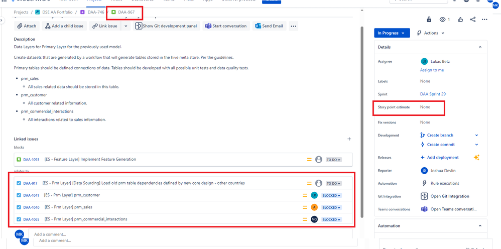

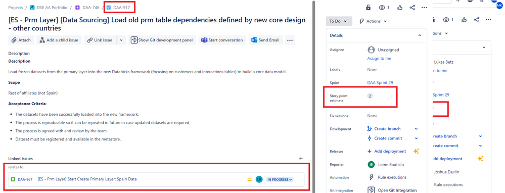

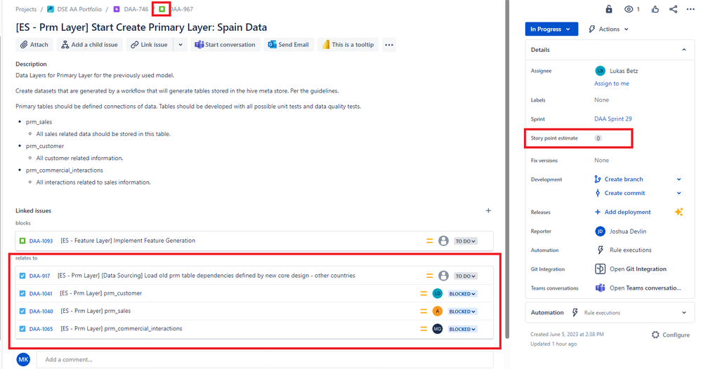

And Ive tested with this task, see that task is related and it is 2sp:
And the story has "none" in the sp estimate field:

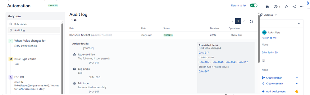

Then, when I change the task to five, that is what happens:
The story changes the field from "none" to 0...

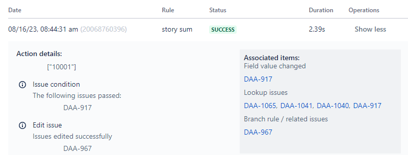

But, in the logs, I can see it is actually suming up:
Any idea????

Evgenii
August 16, 2023
@Marja Kalinke just remove char s :)
