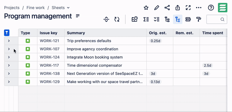

if you are open to solutions from the Atlassian Marketplace, I think you'd like the app that my team and I are working on, JXL for Jira.
JXL is a full-fledged spreadsheet/table view for your issues that allows viewing, inline-editing, sorting, and filtering by all your issue fields, much like you’d do in e.g. Excel or Google Sheets. It also comes with a number of advanced features, including support for (configurable) issue hierarchies, issue grouping by any issue field(s), sum-ups, or conditional formatting
With these, you can build a report like e.g. this in just a couple of clicks:
This is really just one of a virtually endless number of possible views and reports - you can freely configure your issue hierarchies and structures, use different sum-up techniques, etc. etc.

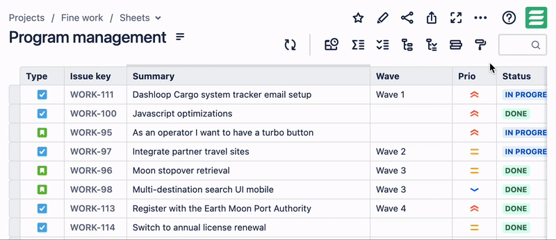

Regarding your specific use case: JXL comes with a powerful conditional formatting feature, so highlighting certain values generally works great:
The tricky part would be the dependencies between different fields and values: E.g., I understand that you would have to sum up (combine) two values, and compare it to the issue's SLA. That's not currently possible in JXL (however, will be in the future!), and you'd have to workaround this via some kind of scripting, e.g. Jira Automation. I.e., you'd do the math in your script, write the result into a custom field, and then use the custom field in JXL to do the highlighting.
