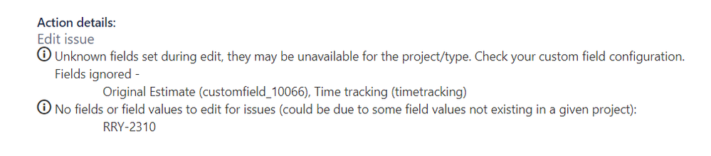

Can you please help me to understand why the automation I created does not work?
I need the values from "QA Estimate" and "Dev Estimate" custom fields sup up every time I change the values in the fields and go to the "Original Estimate" standard field.
This is what I did:

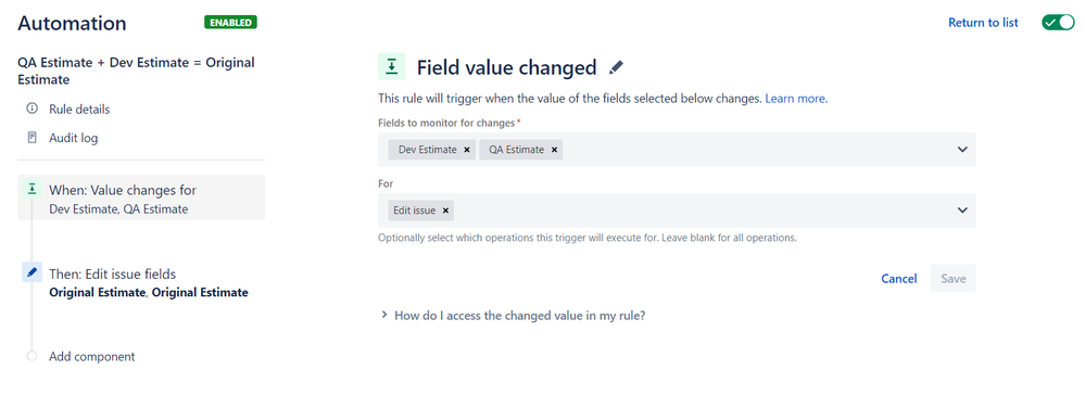

1. Created the Trigger

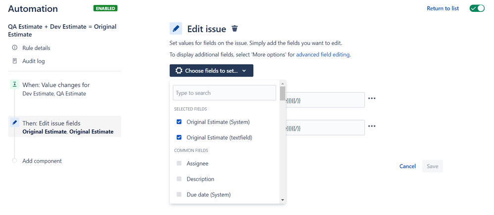

2. Selected both fields "Original Estimate" as I don't know which one I need (at the end I will leave only one when I understand which field I need)

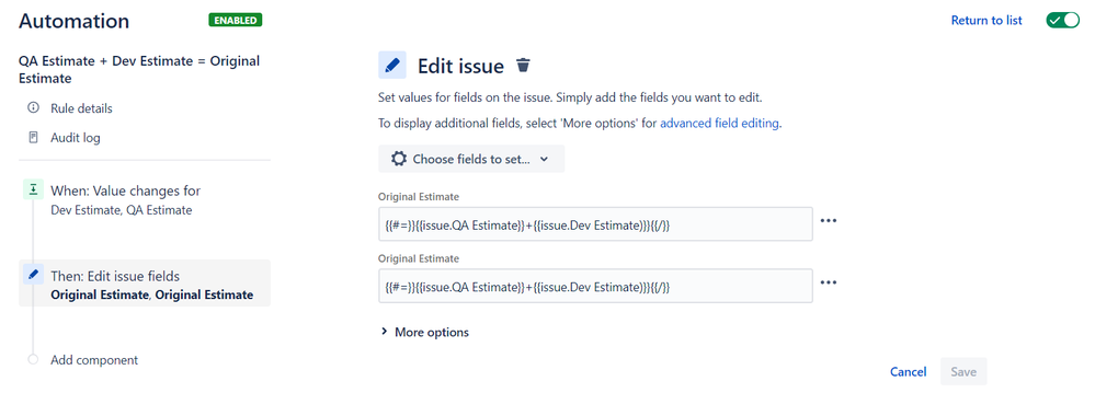

3. Added the following rule into both fields {{#=}}{{issue.QA Estimate}}+{{issue.Dev Estimate)}}{{/}}
4. Then Published all my changes and Enabled the rule

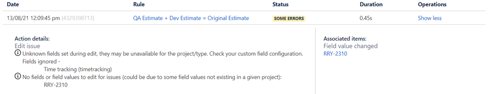

5. Every time I change the values in the "QA Estimate" or "Dev Estimate" fields I get this error:

Hi Alexandr,

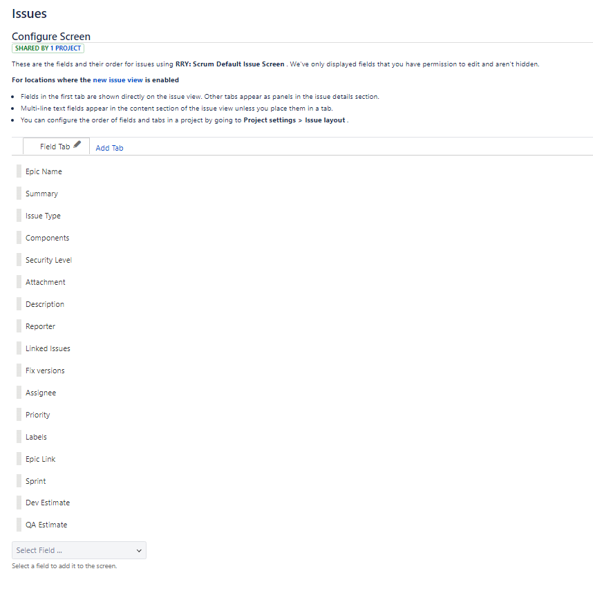

Two things to check for, make sure that the Context for both fields are available for the project RRY.
Second, made sure the fields are on the Edit screen used by that project and issue type.
Also make sure that Time Tracking is turned on for that project.

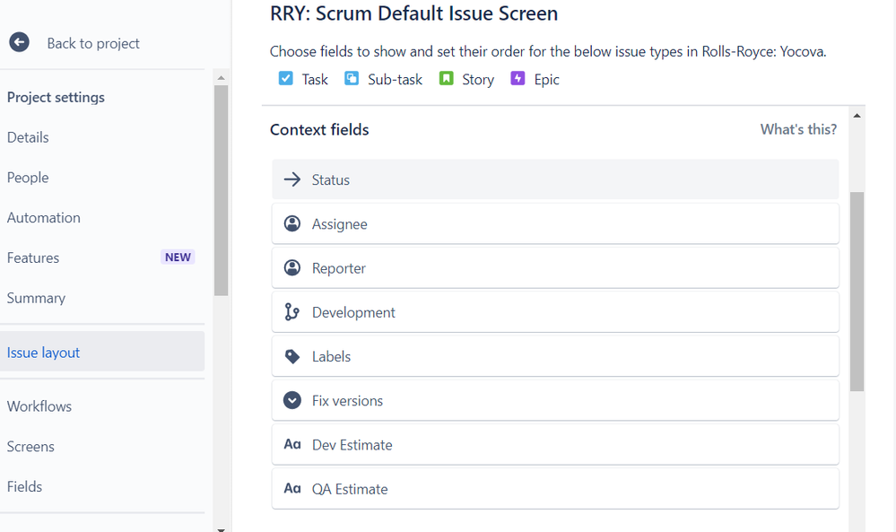

Both fields are added to the Context
Both fields are in the Edit screen

Also, your first image above is the screen layout, that's not the Context. For that go to Settings > Issues > Custom Fields.
Search for the field, then click the 3 dots menu on the right and select Context and Default value.

Can you have a look ad this expression: {{#=}}{{issue.QA Estimate}}+{{issue.Dev Estimate)}}{{/}}
Is it correct?

I do not see the Original Estimate field in your configure screen image above. It needs to be on the screen in order to be able to edit it.

- you may have to use the text field one instead of the original estimate aince the system one actually tracks time and it shows up when you add the time tracking customfields.

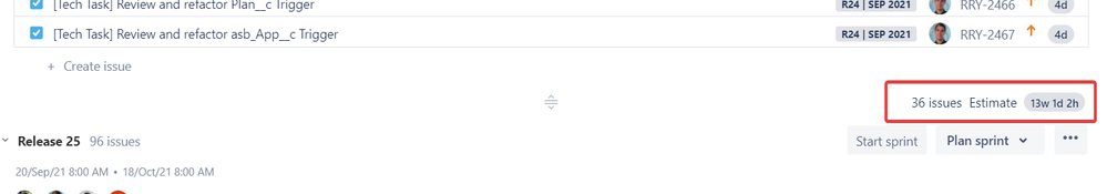

- the whole point is, to sum up the values in the Original Estimate field as it is connected to displayed hours in the backlog view: 6.png
