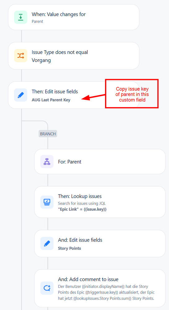

So I tried the following solution for adding a story to an epic, this works great: image.png

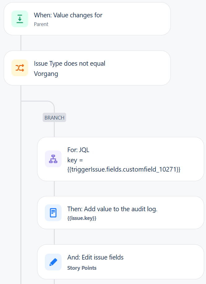

When adding a parent issue to a child issue, my idea is, to populate a custom field (customfield_10271) with the issue key of the parent issue, which I can use for the next automation, when I remove the parent issue from a child issue.
But I'm not quite there yet. When this automation runs, the story points of the epic is always 0, I don't understand, why.
The automation looks like this:
In the log of the smartvalue {{issue.key}} I get the correct issue key of the parent issue, which was removed. In the last step I try to build the sum with {{lookupIssues.Story Points.sum}}, which always is 0.

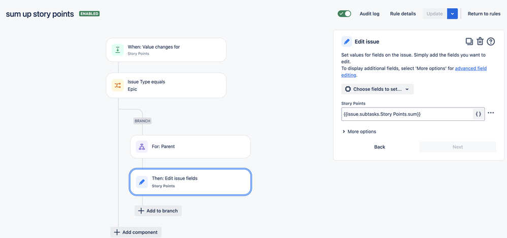

Try this Automation rule
It will work for sure i tried this it works for me

See the following automation rule, of a simple story point sum up in the Epic.
In the lookup action change this to "Parent" = {{issue.key}}
You could change the trigger to value change for parent, or use both fields.

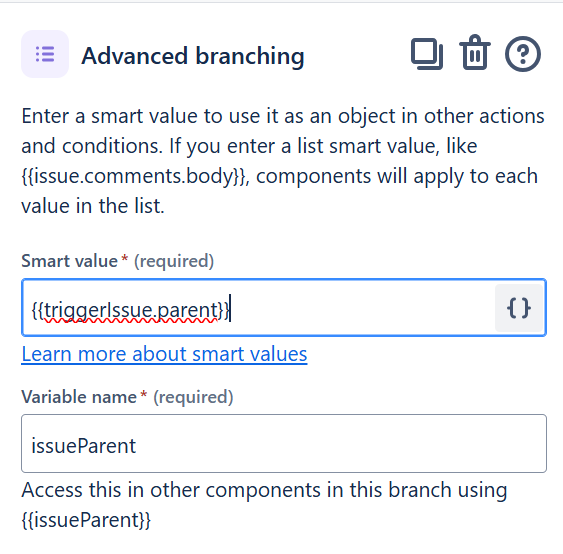

If so, try the following.
Set the branch to advanced branching and the branch details to:
{{triggerIssue.parent}}, name the variable, then do the lookup en and the edit on story points, does this give a  positive outcome?

Yes, the trigger here is "Value deleted" for the field Parent.
I'm not sure, I follow your latest instruction. When I create a branch like this, I get the error "The provided smart value couldn't be resolved to an object". That is correct as well, because at this point the trigger issue has no parent.
