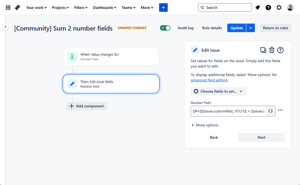

Can you try using math expression directly in the field within Edit issue action (I'm assuming you're using this one?), and not necessarily advanced edit part of the action?
For example, if the third field is also number type (where you're summing previous two values), automation could look something like in the picture above.
You could just use the expression
{{#=}}{{issue.customfield_10121}} + {{issue.customfield_10126}}{{/}}
and it should work.

Thanks @Tomislav Tobijas
Putting the expression directly works fine.

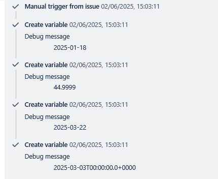

Yes. this is my audit log
Can you share the screen shot of your rule to check if you have fixed the rule?
