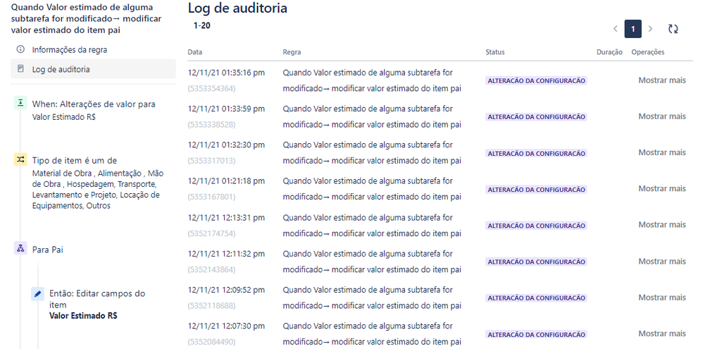

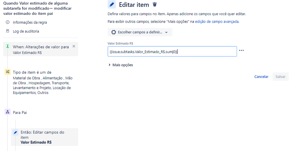

I have a task with some subtasks, and in each of issues have a custom field "Valor Estimado R$", i would that this field in task was the sum of this same field in my subtasks.
I am trying to use a automation that worked it in another project for average, but doens't worked in this case. The most strange is that the rule dont triggered when i change the value of custom field. I expected that leastways a failure in a audit log.

Hi @Douglas Oliveira
Is this a company-managed or team-managed project?
When you note this worked in another project, was it for the same field summation?  If so, was that a company-managed or team-managed project?
Finally, if this is a new custom field you are trying to sum up, have you confirmed the smart value is available via {{issue.subtasks}} with this how-to:
https://support.atlassian.com/jira-software-cloud/docs/find-the-smart-value-for-a-field/
If it is, you may need to use the custom field ID instead of the name, as the name appears to contain a dollar sign character.

Hi, Douglas.
If you try to just log to the audit log that custom field's value for a single subtask, does it work as you expect?  That would confirm if the smart value can access that field.
Douglas Oliveira
November 17, 2021
Hi @Bill Sheboy
No, its doesnt work. Nothing happens...
Bill Sheboy
November 17, 2021
Thanks for that information.  Looking over the backlog, it appears that only some of the fields for subtasks are included in their parent's smart value: https://codebarrel.atlassian.net/browse/AUT-224
That means the only way to sum those accurately is to use the work-around by calling the REST API with JQL in a web request, and then summing the result using list functions.  If you would like more information about that technique, please let me know.
