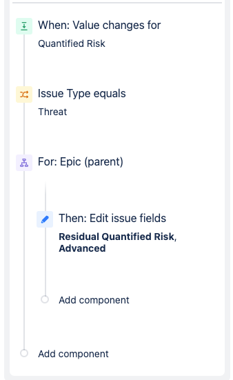

Hello everyone,
I'm back with another automation question 😅.  I've read all the suggested posts and they make sense, but there must be some small error I'm making that I'm not noticing.

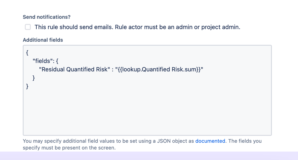

We have an epic which has a custom field called "Residual Quantified Risk."  Every issue in the epic has a field called "Quantified Risk."  I want to sum the Quantified Risks from the issues into the Residual Quantified Risk in the Epic.  This is what I have so far.  The audit log says only "config change," even though I've tried to trigger it many time.
Thank you again for your help!
3 answers
2 accepted

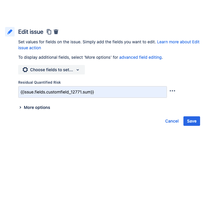

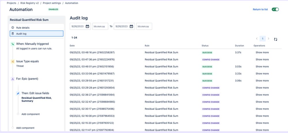

Good morning from blustery Finland!  It is definitely the right audit log, and it's a company-managed project.
I already tested changing the editing part, so that changing the QR would change the summary, and that worked.  It's just the part where it sums the QRs in the RQR field that doesn't work.

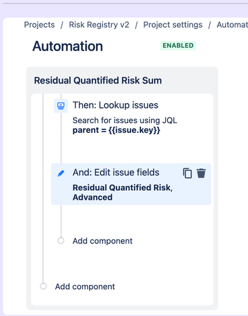

so you need to have a lookup issues component immediately after your epic branch component...
Then lookup issues JQL parent = {{issue.key}}
Like • # people like this
Lana Kelly
September 27, 2023
Okay, so it found the correct issues, but now it's still not summing anything.
Jack Brickey
September 27, 2023
Please share your current rule via screenshot.

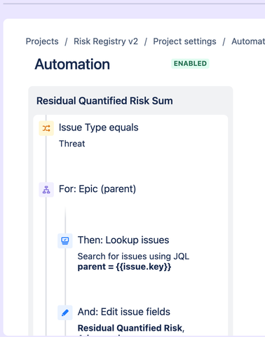

It's much the same as when I firstScreenshot 2023-09-27 at 16.18.10.png posted, just with a new lookup portion.

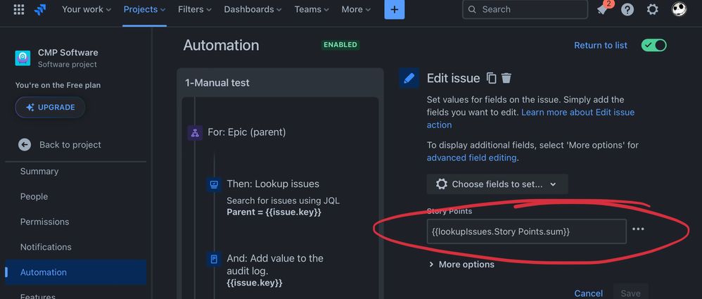

Jack Brickey
September 27, 2023

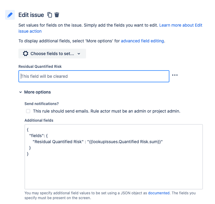

can you replace "lookup" in your edit issues JSON with "lookupIssues"? If that does not work can you simply place {{lookupIssues.Quantified Risk.sum}} into the short form field box as in below example rather than in more options?
Bill Sheboy
September 27, 2023
Yes, and...if that does not work, the smart value for the field may be incorrect.  Sometimes a field's display name on screens is different than the smart value.
You can check that using this how-to article to identify your smart value, or use the custom field id as an alternative: https://support.atlassian.com/cloud-automation/docs/find-the-smart-value-for-a-field/
Like • Jack Brickey likes this
Lana Kelly
September 27, 2023
Oh my goodness, the last bit was the lookupIssues.  You know how you change things many times to test why it's not working and then forget to change it back...?  Thank you so much @Jack Brickey and @Bill Sheboy
Now just to change the trigger and hope it still works.

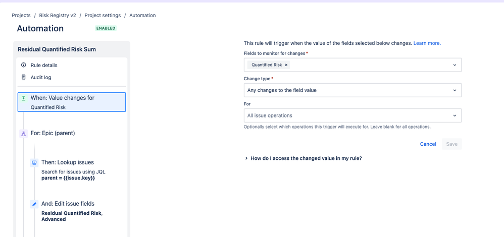

Lana Kelly
September 27, 2023
It does not 😔.  I added this trigger (and took away the "If issue type is Threat" condition, since it's a project rule)

September 25, 2023
Hi @Lana Kelly
Your rule is referencing a Lookup Issues result to sum the field, but your rule does not have a Lookup Issues action.
Please add that action, with the JQL to gather the children of the epic, before your edit and the rule will work as you expect.
Kind regards,
Bill

How do you search for the relevant issues?  I've tried
parentEpic = {{issue.key}}
parent = issue.key
parentEpic = issue.key
"Epic link" = {{issue.key}}
"Epic link" = issue.key

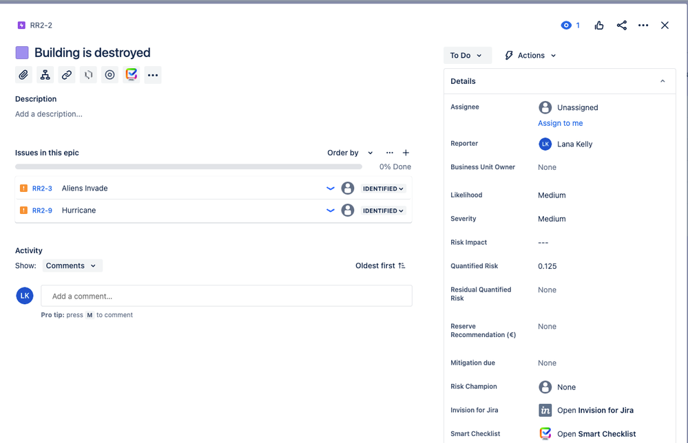

I changed the automation to change the description of the epic, and that worked, so it has something to do with the command to sum the QR fields and enter that value into the RQR field.
This is the original screen.  The RQR field is on the right.  The QR field is the same automation as the issues in the epic.

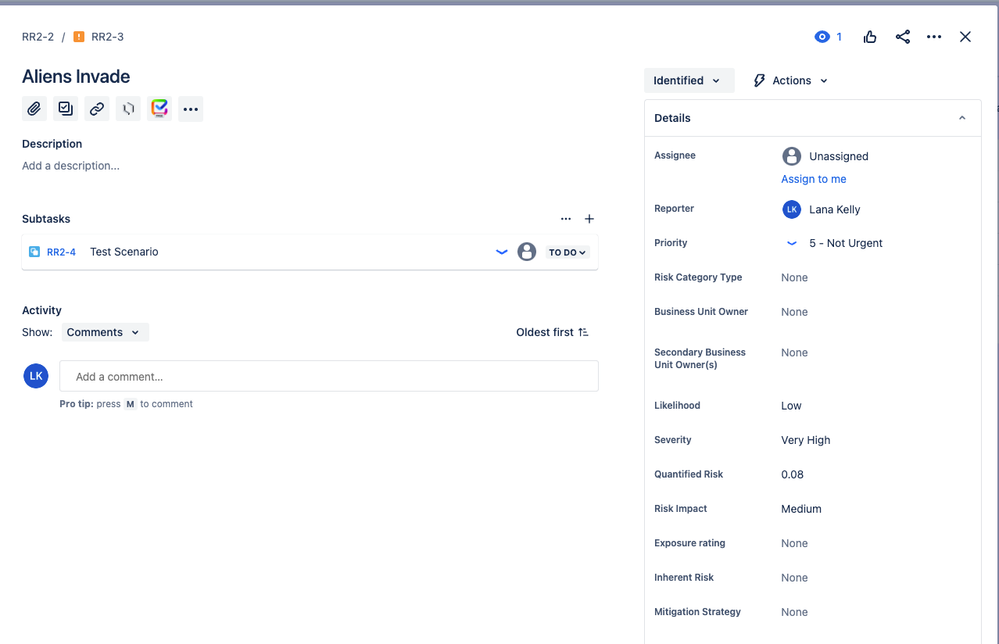

This is the original Aliens Invade issue.
This is the changed Aliens Invade issue.  The QR has changed according to the automation.
The Epic stays the same.

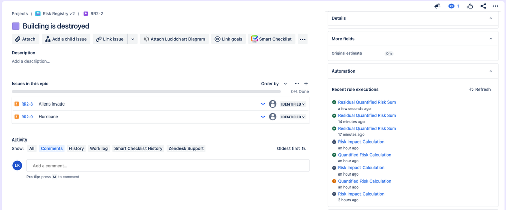

And here, it shows the execution.
Then, I changed the automation to change the summary when triggered and it did.
