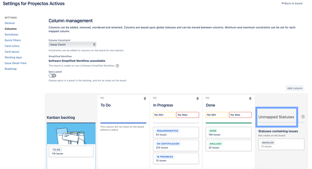

Claudio Gonzalez
August 5, 2021
Hi @Julianne Soifer
The first can you use only "project = VP3" because the results include all issue types (task and sub-task). Additional you need check the configuration columns into board and check the right side to Unmapped status
