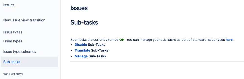

Subtasks are enabled. Under Settings > Issues > Sub-Tasks, it says "Sub-Tasks are currently turned ON.".

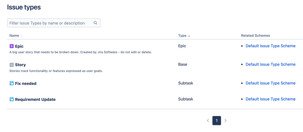

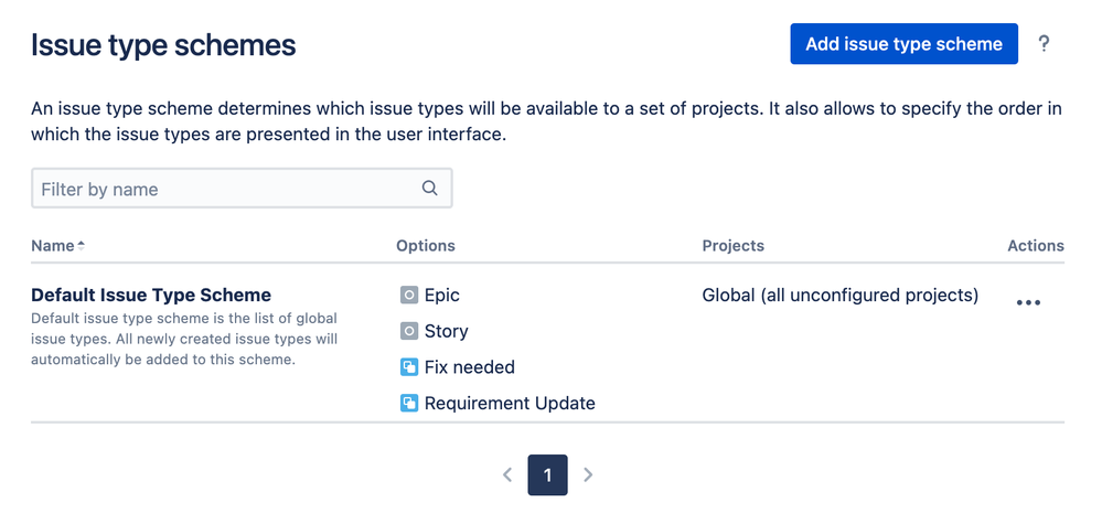

Selected settings > issues and added 2 new issue types as sub-tasks. Screenshot 2021-12-25 at 12.02.20.png

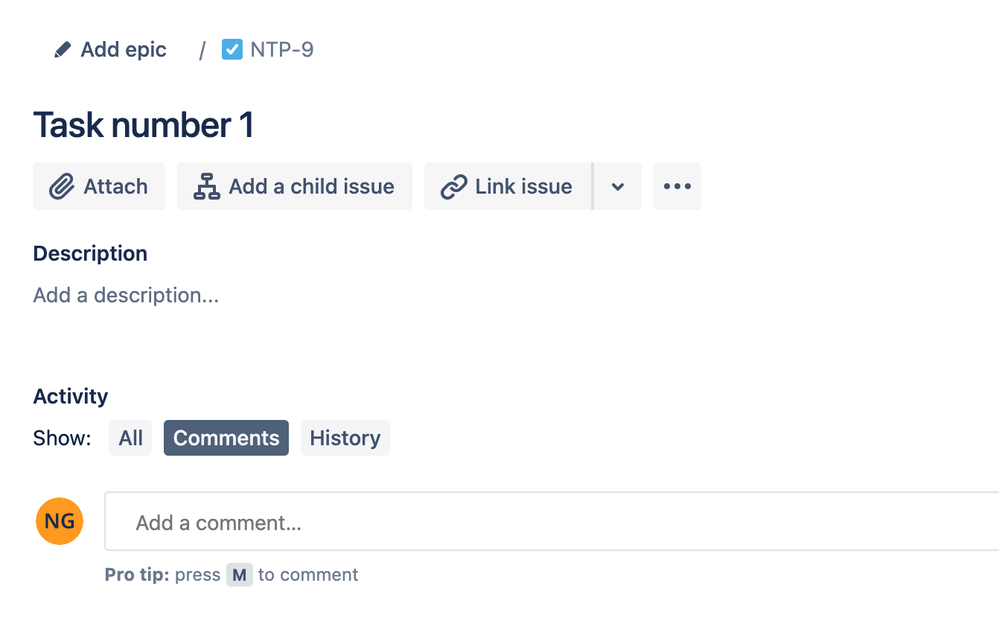

Created a new task and added it to my current sprint. Still no subtask option. The only option is "Add a child issue".

Your first screenshot is the list of issue types.  It tells us that you definitely have two in your system, but have you associated them with the project as well?  What does the "issue type scheme" for the NTP project say?  Does it include either of the sub-task types from the global list?

Ah, those two screenshots are really useful.  The first one shows us the issue types that are in the default issue type scheme, but paired with the second, there's a dead giveaway.
The icon for NTP-10 is a white tick on a blue background.  The default issue type scheme with the sub-tasks in it does not have tasks in it.
So, the NTP project is using an issue type scheme that is not the default!
My guess here is now that the issue type scheme for NTP does not have sub-tasks.  You can either edit the NTP scheme to add the sub-task type(s), or swap NTP out to use the default scheme.

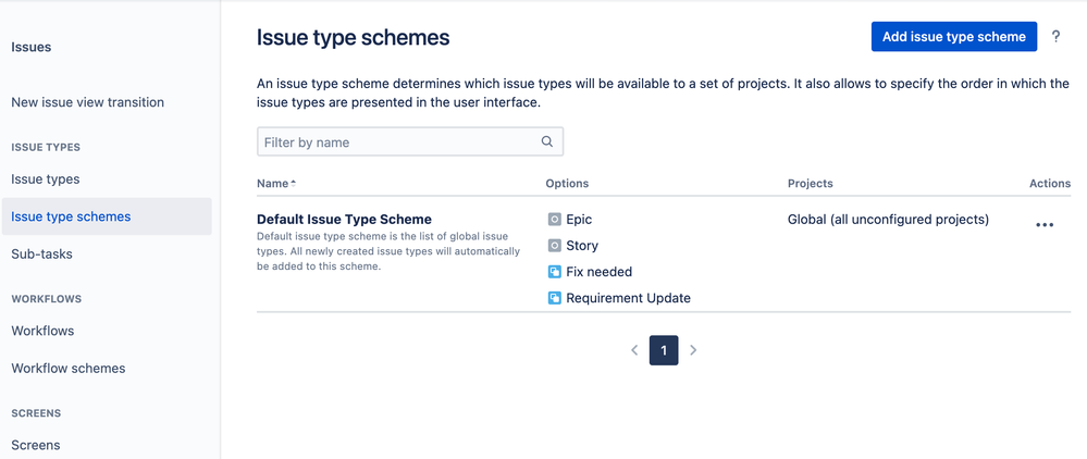

Hmm. I'm a bit confused by that one too. When I look at the Settings > Issues > Issue Type Schemes, it seems to say I have added these 2 sub tasks types to the right scheme (Default Issue Type Scheme). Screen shot below.

It's not.  That issue type scheme is not in use in the NTP project.
The NTP-10 issue is of a type called "Task" and has the little white/blue tick icon.
That scheme does not include "Task", so it is not used by NTP.  You can't have an issue of a type that is not in use in the project.
NTP is not using that issue type scheme.

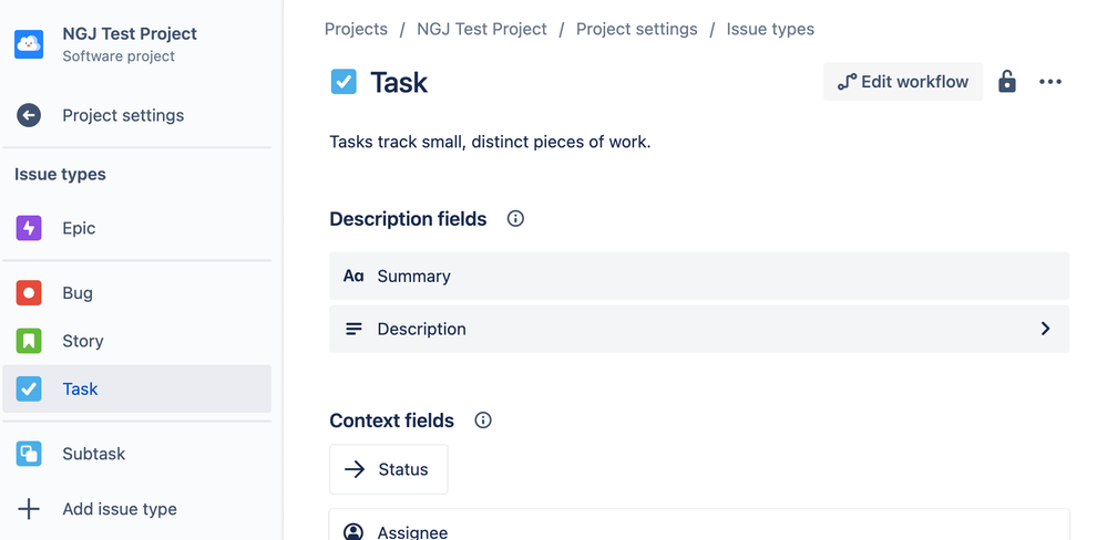

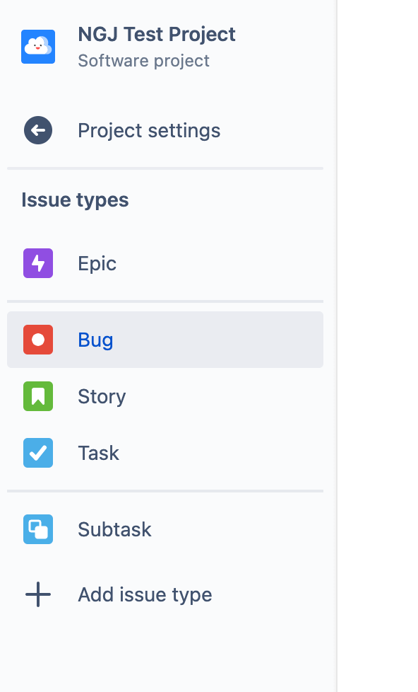

I have selected the project, then Project Settings > Issue Types and I see the following. This would seem to imply that tasks are available to the project.

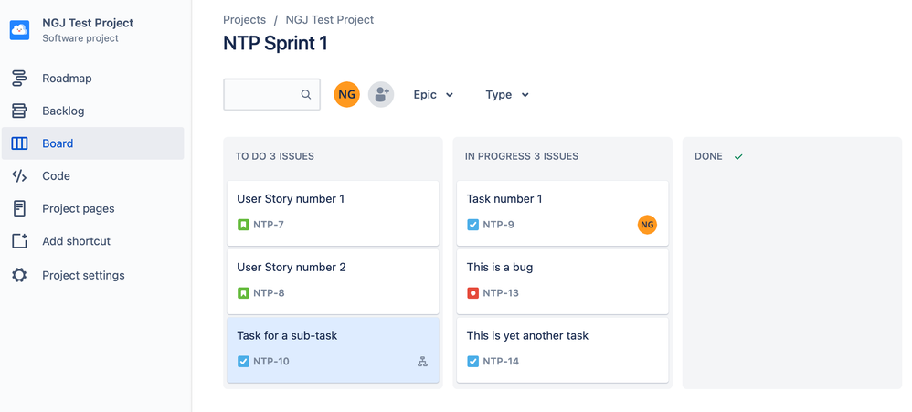

Also - I'm pretty sure I do have tasks in this project. Again, screen shot below from one of my sprints showing that. Forgive me if I am misunderstanding something.

Ahh, no, I see.
You are looking at a team-managed project.  These do not use issue type schemes, they are configured individually.
Your first screenshot there shows that you've already added subtasks to the project, so all you need to do is go to an issue you want to break up into sub-tasks and click "add a child issue"
Note that team-managed projects only support a single sub-task type, called "sub-task", you can't do your "fix needed" and "requirement update" (yet)

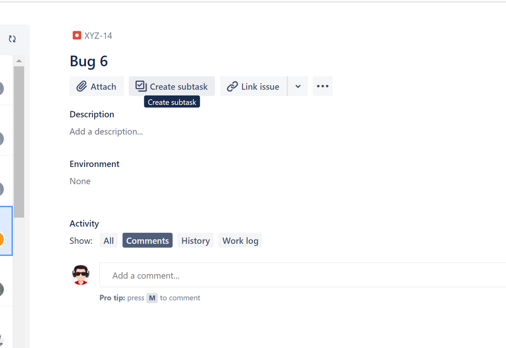

In cloud here is a screensoht:
I hope this helps.

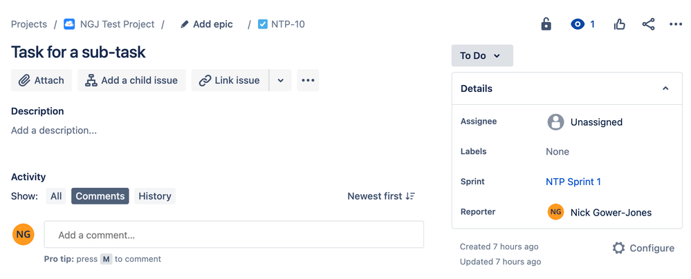

Thanks for your answer, but this is exactly my problem. When I open up an issue, there is no "create subtask" button showing, as you can see from this screenshot. Screenshot 2021-12-25 at 10.25.27.png

Have you tried clicking on "add child issue" and see what happens?
Nick Gower-Jones
December 25, 2021

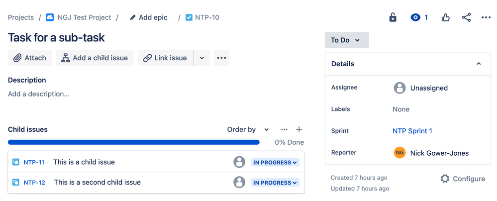

It seems to add something that look like a subtask (the icon is the same), but I can't select either of the new subtask types which I have added to the issue type scheme. I have added two child issues in the screenshot below to illustrate

Okay, I am now seeing add a sub-task OR a child issue. I since I only have child-issue as a choice, it is basically acting in the same way as a sub-task did. Is the only difference sematic? (Team-managed vs company-managed)?
Nic Brough -Adaptavist-
April 8, 2022
No, both types of project have sub-task abilities, but they are configured in different ways. In company-manged projects, you have to create one or more issue types classed as sub-task types and then add them to the "issue type scheme" to tell the project it can use them.  In a team-managed project, you go to project admin and issue types and enable the sub-task type.
