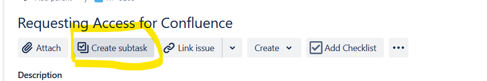

Vikrant Yadav
April 25, 2024
Hi @Tom Elfers  Welcome to Atlassian Community!
Sub-task issue type is not visible on Create issue screen.
After issue creation, you can create a new sub-task for a Task issue type.
You can create Sub-tasks in bulk using CSV import or via API.
Previously, if you had sub-task issue type in your project and removed sub-task issue type, then where you moved the sub-task issues, without moving issue to another issue type, you can't remove issue type from Project issue type scheme.
Thanks

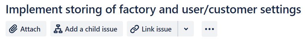

Tom Elfers
April 25, 2024
That's weird - your "Create subtask" option shown looks different from mine:

Vikrant Yadav
April 25, 2024
@Tom Elfers It's the same. In my screenshot I am at Task issue type. While in your screenshot you are at Epic issue type. For Epic issue type, Jira shows "Add a child issue" and  for issue type below Epic it show "Create Subtask"
Tom Elfers
April 25, 2024
Ahh, of course! All context sensitive.
