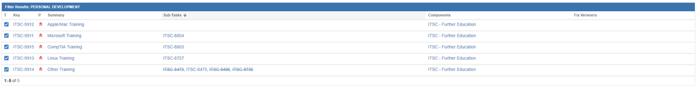

Screenshot of my gadget.
example.pngThanks

Okay. So this solution works if all of tasks and subtasks are showing in the summary column. The subtasks are now removed.

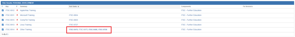

However my main issue is the sub-tasks column. If you take a look at the screenshot you will see subtasks with and without a strike-through. I would like to hide the ones with the strike-through (they are closed/resolved).
Thanks.
Nic Brough -Adaptavist-
December 12, 2017
That's where Ivan's clause comes in.  The strikethrough happens when an issue has a value in the resolution field.  So "and resolution is empty" will remove those from the results.

Okay I understand, but it does not work...
With my filter looking like this:
project = ITSC AND status in (Open, "In Progress", Reopened) AND component = "ITSC - Further Education" AND assignee in (ahendriks) AND issuetype in standardIssueTypes() AND resolution is EMPTY
I still see the strike-through subtasks. I seems as if this entire string does not have any impact on that subtask column.
Alwin
Ivan Tovbin
December 12, 2017
Try removing "AND issuetype in standardIssueTypes()"
December 12, 2017
Sorry, I've completely misunderstood it.
The subtask column is a single field.  It displays subtasks, unfiltered.  So the filter in use for the gadget is irrelevant, because the data in there is not issues being selected.
You'll need to find a new "subtasks" field, one that can filter for unresolved only.
Ivan Tovbin
December 12, 2017
Indeed, what Nic said there.
