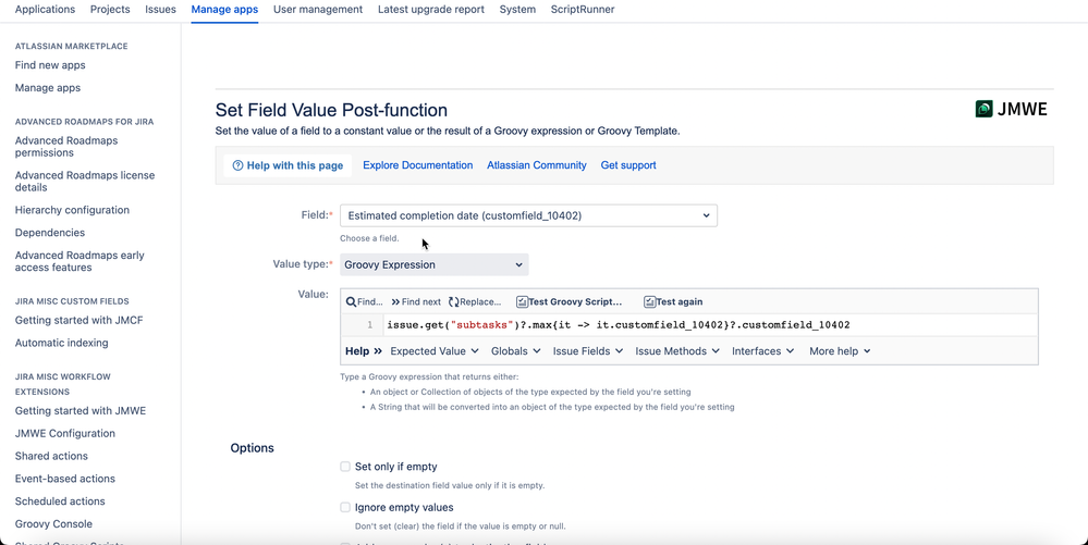

Hi Lakshmi,
To achieve this with JMWE, you will need to use Set field value (JMWE app) post-function with the following code:
issue.get("subtasks")?.max{it -> it.customfield_10402}?.customfield_10402
You will need to replace  customfield_10402 with "Estimated completion date" ID, I hope it helps and let me know how it goes.

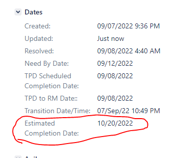

The main task is not reading the value. I have added this on create transition on subtask workflow, I have added the field on Main task view screen, but the values is not updating on the main ticket. In the post function, its showing the correct value.
This is main ticket :

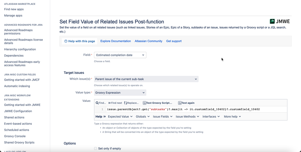

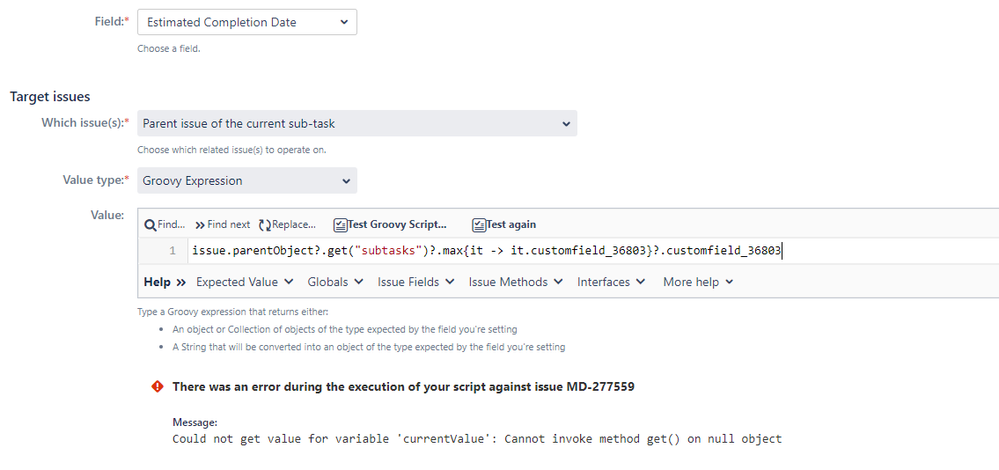

If you are setting the Parent's Estimated Completion Date from the subtasks workflow then you will need to use Set field value of related issues (JMWE app) post-function with the following code:
issue.parentObject?.get("subtasks")?.max{it -> it.customfield_10402}?.customfield_10402

@jira_admin_cu create transition of subtasks or main task? do you get any error when testing the code? can you share a screenshot from your setup?

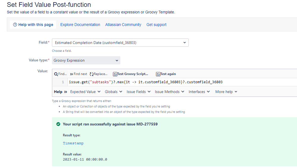

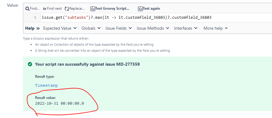

Hi @Sayed Bares [ServiceRocket] , Appreciate for your quick reply. I have added this code on main ticket create transition
 Its showing the correct value when I testing in the workflow post function

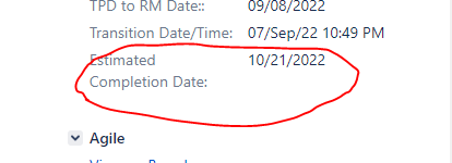

But the right value (which is subtasks furthest away "Estimated Completion Date") is not updating on Main ticket
