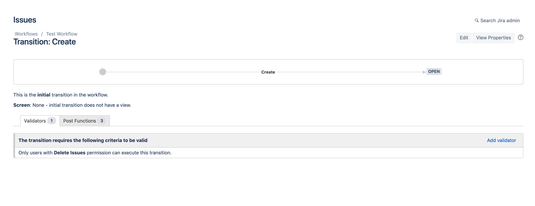

If you have a separate workflow from standard issue types you may have a Permission Validator on the create issue transition that only users with a particular permission can execute the transition.  As an exe on the following workflow i changed it from create do delete permission:
Details on working with validators and workflo modifications can be found at:
Check this out and let me know if this is the case.
