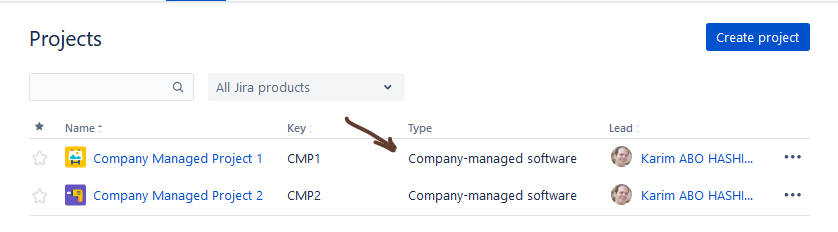

For your special project, i would recommend to use a company managed project instead of Team managed project. if this is not the case, you will need to create a new one.
here is how to verify your project type, open the project list and check the type as below

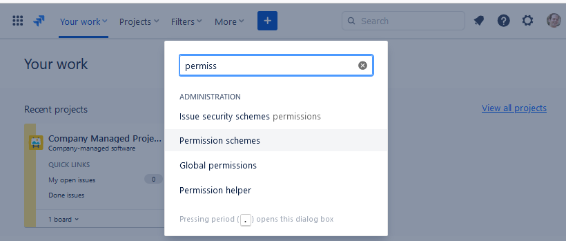

  1.  While you are logged in (wait for few seconds) type gg on the keyboard, this will open the special admin menu and then type permission schemes.

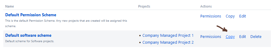

  2. Make sure that the permission scheme used by your you project is not used by other projects. If this is not the case, copy the permission Scheme

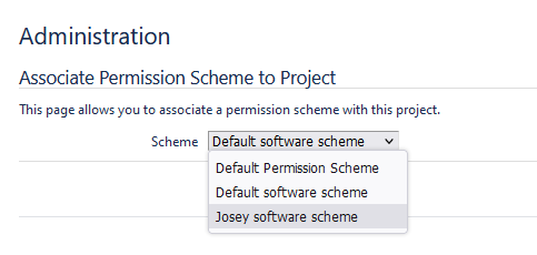

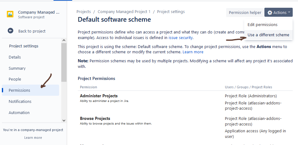

  3. Now let's assign the new copied scheme to your project. go to your project and from project settings, go to permissions then from top right Action Button select 'use different scheme'
  4. Select your copied permission scheme
Now you can modify project permissions without impacting other projects.
