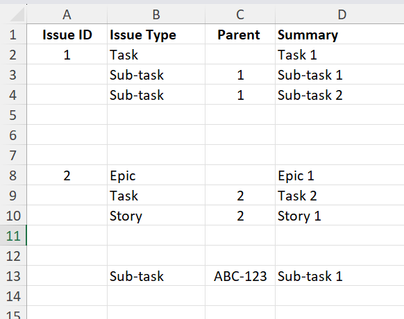

John Funk
October 21, 2025
Hi Saskia,
You can create the parent and the child at the same time. Or you can create the child and reference the key of the parent when you import the child.
In my example below I have using Epic and Story, but Task and Sub-task would be the same process.
The last example is if you are just creating new Sub-task and linking it to an existing parent.
