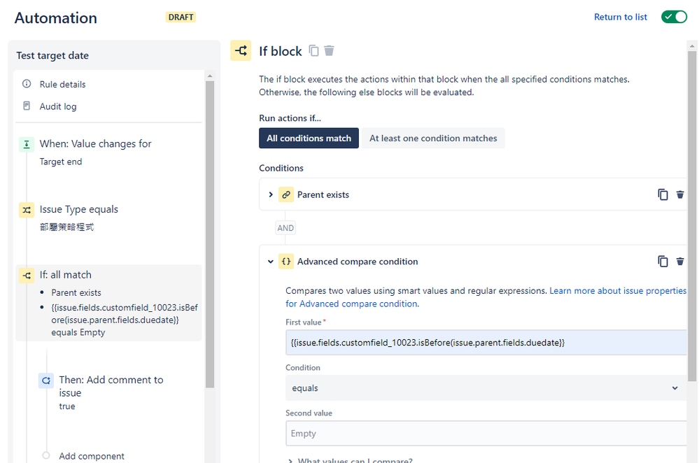

彥宏(Luke) 劉
August 6, 2023
@Bill Sheboy
Here is my automation rule , but it's not working.
May be the first value is fault?
Bill Sheboy
August 6, 2023
What is the field type for your custom field?  If they are not both date type I wonder if the comparison using isBefore() does not work as expected.  You can check this by writing the value to audit log (or checking the field configuration)
Another thing to try is to use the same format for the two fields (i.e., your custom field and duedate), and modify the comparison:
  • first value: {{issue.customfield_10023.jiraDate}}
  • condition: less than
  • second value: {{issue.duedate.jiraDate}}
Like 彥宏(Luke) 劉 likes this
彥宏(Luke) 劉
August 6, 2023
@Bill Sheboy It's working now!!!
