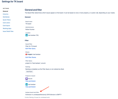

1 - Kanban boards can be configured with an additional sub-filter in the board settings. That being said, I suggest you navigate to ... > Board settings > General and check if you don't have a sub-filter that might be removing your sub-task issues from the board:
2 - To ensure this is not related to your board filter, run the main filter in your issue navigator and make sure it is returning your Sub-task issues, also considering the Sub-filter query mentioned in step 1.

looks like step 1 was the issue. there was a sub-filter on the board for fixVersion being empty. however it appears since we did not list the fixVersion as a visible field on sub-tasks it was filtering them out.
Issue resolved!
